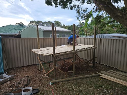

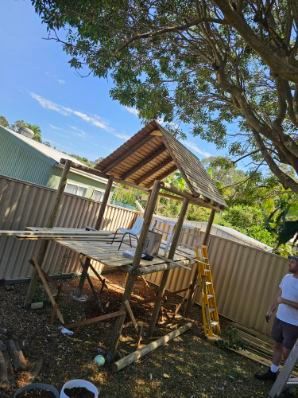

Cleared the back yard area of trees scrubs

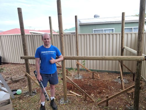

dug post holes for frame work
concreted in post with stabilising frame work
measured and built flooring section

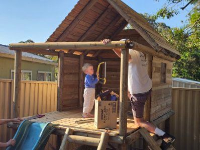

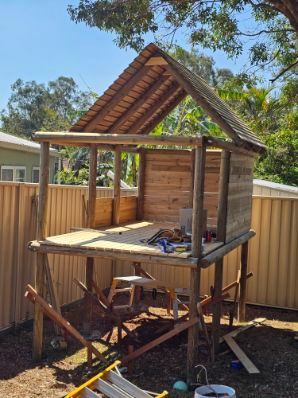

built roof frame struts and bolted to upper frame
over lapped roofing panels nailed into frame
Cut out window section for side walls and panelling

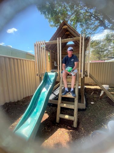

added the vertical safety rails for the veranda
attached slippery dip and hand built ladder and stairs
contested base ment blocks for stairs and ladder

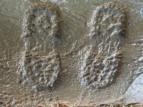

impressed Teddys boot soles into the wet concrete and added the year 2025
added a red plastic drivers wheel to front deck post
cut all the bolt ends off and smoothed edges
Nailed into centre of roof frame solar lights for buddy house section
