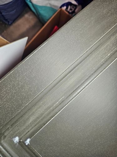

So I am spraying my cabinet doors with a little handheld Wagner sprayer (really wish I had upgraded for this project!) I was getting pretty decent results but a combination of weather, thinning and gun settings led to a handful of doors developing some cracking which I know is due to too thick of paint. So I've sanded them back but even though the surface feels super smooth I can still see the pits and cracks. I hand sanded with 120 and then did a smoothing pass with 180 and 240 afterwards. I'm worried that even if it feels smooth the paint is still going to sink into those cracks and pits? Do I keep sanding until I can't see them? I've sanded for ages and feels like they just get more noticeable. I was only going to put one more coat on as it already has 3, but maybe if I do 2 it will hide?
