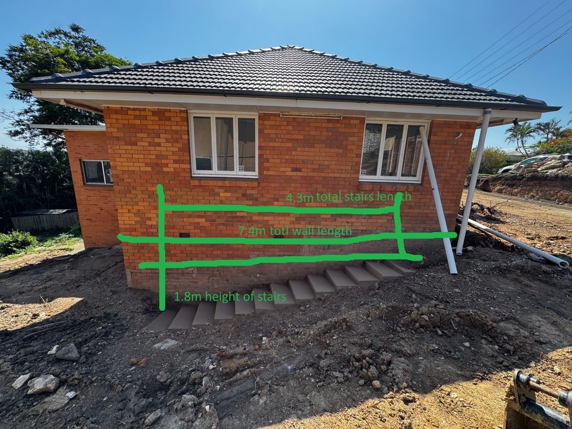

We’re upgrading our outdoor area and incorporating exterior waterproofing. As part of this, we’ll have a gravel path sitting above geofabric-wrapped drainage gravel, which covers the foundation drainage.

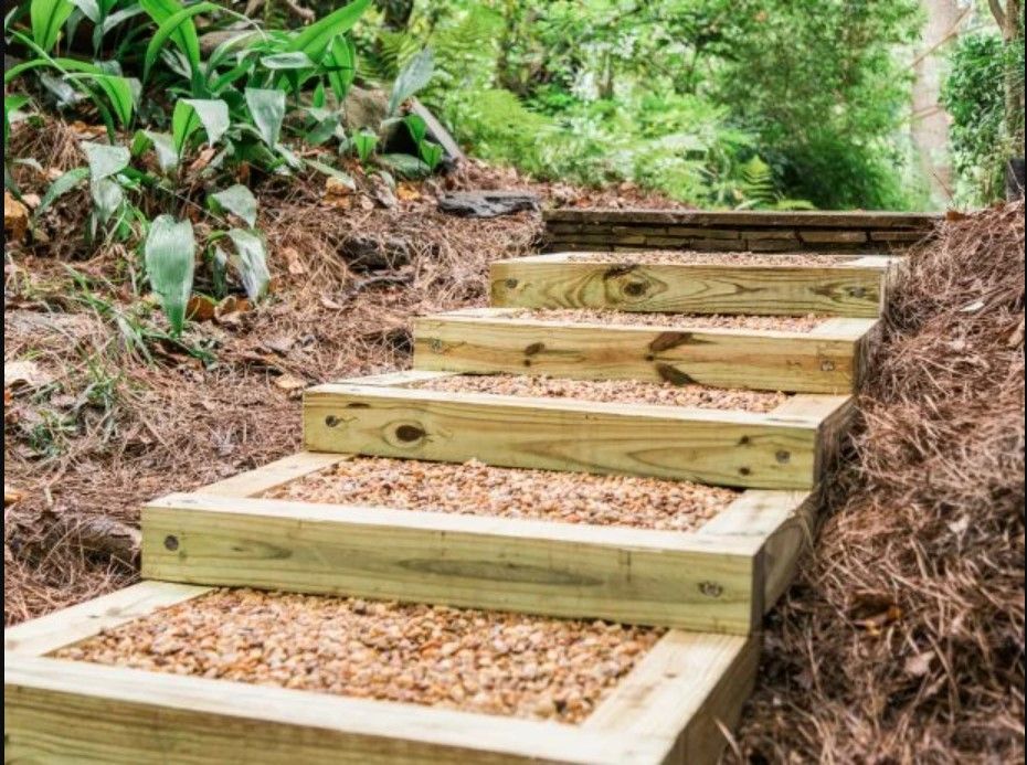

We’d like to install landscape-style timber stairs (see attached image for reference). Normally, these stairs require rebar—typically 450 mm long—driven through the riser posts into the ground for anchoring. However, one side of our steps will sit directly above the drainage gravel, meaning there’s no firm soil below for anchorage.
How can we construct the steps securely in this situation?
I understand one option is to move the steps roughly 600 mm away from the wall so they sit entirely over compacted earth, but ideally, we’d like to keep the stairs under the eaves for shelter from rain.
Question 2: Protecting the Waterproofing and Drainage Board
If we do keep the steps close to the wall, I’d prefer not to attach them to the brickwork since the wall will be covered in a dimpled drainage board as part of the waterproofing system. Any movement in the stairs could damage that layer. Is there a way to protect the drainage board while keeping the stairs close to the wall?
