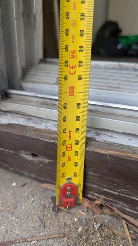

I'm building a deck on the back of my house. Unfortunately the previous owners put a useless crappy 1m wide concrete patio on. I can't remove it as it supports the brick veneer which was added later. I've attached a photo of the distance between the slab and the sliding door frame. I'll be using 90 X 45 for the joists, but am concerned about the raised height of the 90 X 45 joist with the 19mm decking on top. I could use 70 X 35 on the 1 meter section and then drop the headers to make sure the 90 X 45 joists meet the height of the 70 X 35 for the section of the deck that isn't on the concrete slab. My question is. Is there any other materials I can use to lower to height of the deck that covers the 1m concrete patio that meets the glass sliding door. Could I use 90 X 45 on its side , and then just build a box /ladder frame with 450 centres, that would have the deck height lower to the sliding door, then switch to the 90 X 45 for the portion of the deck supported by bearers . Unless there is another low profile alternative to 70 X 35 , like aluminium or something? Any ideas?
