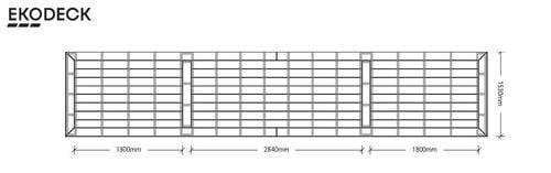

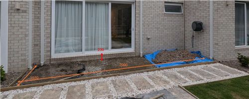

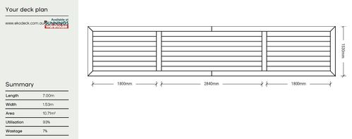

Plan and reference photo attached.
Any advice would be greatly appreciated, thank you!
