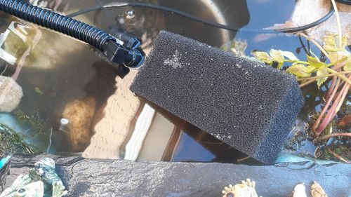

As per @JacobZ's suggestion and I strongly suggest you also purchase a pre-filter sponge.
Looks like this and easily replaced when needed.

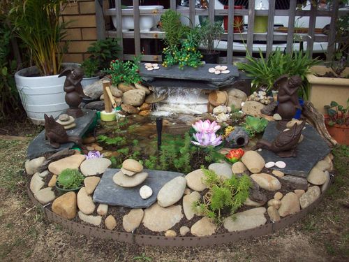

Our pond... and I like your froggy pond.
