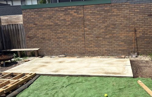

Hi team. I’m at the planning phase and wanted to see if my idea has any merit before I go down the engineers and permits path. I want to build an undercover area for my bbqs and pizza oven. Total size will be 3900 x 3300 x 2700. What I want to know is can I have a single span off 3900 across the front. It will come off the brick wall and I was thinking a ledger off the brick wall secured with chemset and bolts and a beam off 190 x 45 supported by either a 100 x 100 posts and I’m just trying to make the front as open as possible and not have extra posts if possible.
