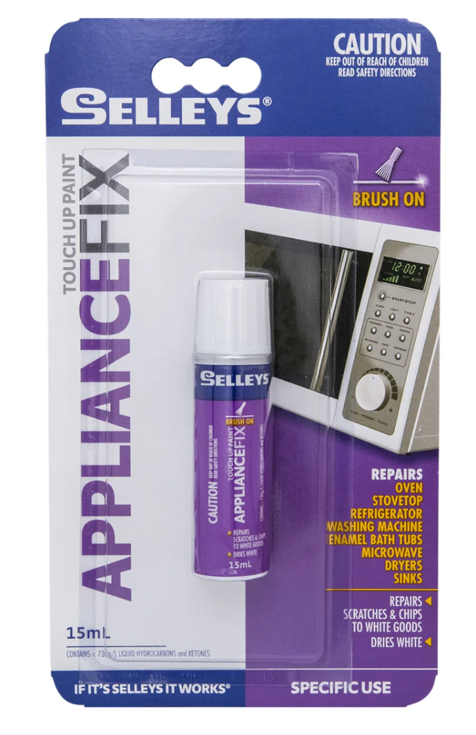

what about Selleys Appliance paint it shows a MW & stated that it is good for MW
I have also seen some MW paints on Amazon
Are you referring to this white touch-up paint? If so, it is heat-resistant up to 200 degrees Celsius.
