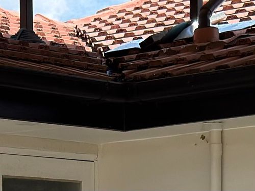

When it rains, Roof valley that is meeting down at the at the bottom ofter leaks in to the eves and water enters in to ceiling and wall (baser block wall) etc.
what can I do to fix this please?

I am very happy to share this with you. Apparently leak was not in cracked tile or lead flashing. There is a small hole on the post which is supporting air patio. Whenever it rains, air patio has smal drops of rain dripping on to post and going into that hole. Phewwwwwwww. I have attached photos
I have sealed that hole with aluminium tape. No more leaks now 😆.
Just wanted to ask though, that air pipe has been out side or can i cut it below tile and keep under the tile. That way i can have full tile with no flashing or leaks in future?

Not the post, if you could please refer back to my original photos there is air outlet pipe next to it. That is what I am wondering if I can cut it and keep it into the roof rather than outside the roof. That way i can remove the flashing entirely and put full tile there.
Apologies for that.
I'd say it is likely that it is a sewer vent pipe, which expels sewer gasses and helps to equalise air pressure in your plumbing system to prevent backflow issues.
I am not a plumber, nor do I have access to the relevant code, but from a quick google search, it seems that a vent pipe must extend at least 300mm above the roof to prevent harmful sewer gasses entering the roof cavity.
So, it seems unlikely that you can alter that pipe, but you could always contact a plumber for their opinion.
