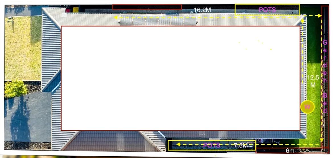

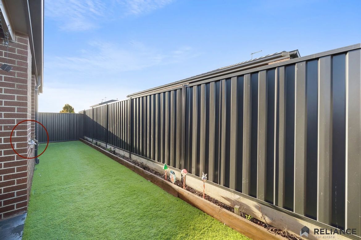

I’m setting up an automated irrigation system for my backyard and would like some advice on my layout and parts list. I’ve attached a marked-up photo showing the planned pipe routing, garden bed emitters, and pot feeds.
My plan is to run a 13 mm poly main line around the garden bed, install PC shrubblers directly into the poly for each plant, and then run 4 mm lines to spike shrubblers for the pots. I already have a single-outlet tap timer.
Before I buy everything, I want to confirm whether this setup makes sense, whether I should use poly or drip tube for the garden bed, and whether I need a pressure reducer for this configuration.
Additionally:
Which brand is best to go for?
Which connectors are most efficient and reliable? I don’t want connectors that become loose or disconnected under pressure.
I’ve seen some poor reviews for certain connectors from Holman — is it okay to mix and match fittings from different brands (for example, using parts from Pope or Toro instead)?
