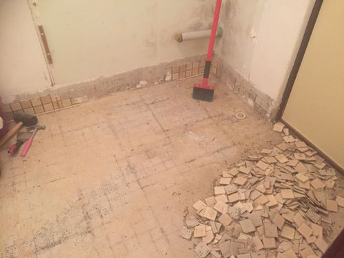

I have removed my floor and started to remove my skirting tiles and found a couple of issues.

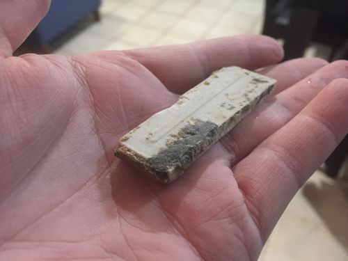

Firstly it appears I have mildew/mould in the top layer as you can see from the photos which I will firstly try remove with a vinegar based mixture (them move to bleach if required).

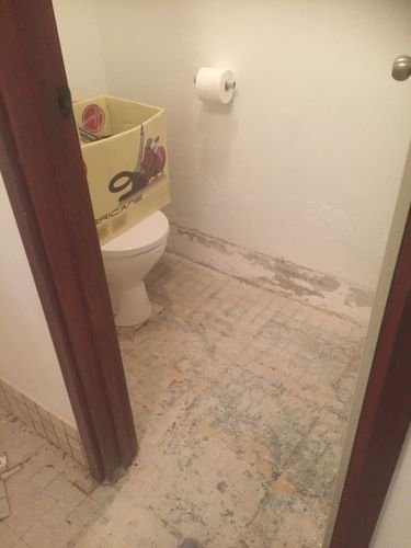

Secondly, my subfloor appears to be a sand based screed which has a few chunks missing after removing tiles. Is it recommended that this layer be removed and replaced with a newer stronger layer or could a levelling system be used once all loose sand removed (in prep for next stage)?
Thirdly, with my walls where skirting tiles have been removed, bits of the plaster have come off the wall exposing brickwork. Rather than just patching with a filler, I assume that new cement will need to be applied?
