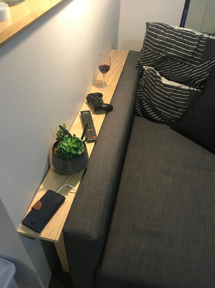

My favourite build so far is featured in the above image. It's also my cheapest, easiest build. A thin edge table between my chase sofa and the half wall. I found a stunning piece of 1800 x 140 x 19 pine from Bunnings. Cut to 1.5 meters and screwed to non structural pine legs, it sits perfectly just below the arm rest for a nice little nook to rest my drink and nick nacks. I'll eventually paint it black and inset shelves in the front.
