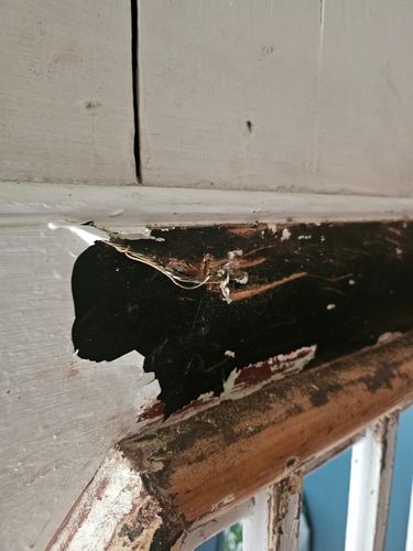

Good morning. So i bought stripper and yes, got some on my hand! 🤪and yes it was not clever at all. Its taken 4 coats of stripper. To take layer off. Im persisting.

Please do be careful, strippers can cause chemical burns if they get on your skin, so a good pair of chemical resistant gloves, like these Ansell Microflex Chem3 Chemical Resistant Gloves are essential.
Regardless, it looks like things are working well, even if it is taking some time. Persistence will pay off in the end.
