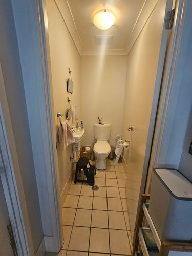

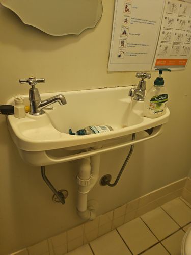

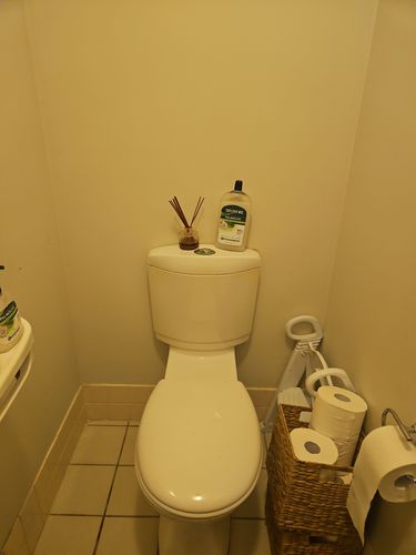

I need to replace my powder vanity as the plastic has a crack in it. I figured I may as well update it all whilst I'm at it. I want to do most it on my own besides the plumbing. My plan is to also install easycraft panels on two side walls, paint and replace the toilet. I've started with some research but want to gain further knowledge from those in the know and who have DIY experience. I'm hoping to do the project over 6 days.
This is my plan along with any questions I still have or seeking advise on which direction to go.
Room measurements
Width: 1015 mm
Depth: 1770 mm
Ceiling: 2330 mm
Door: 725 mm wide, opens inward to right wall
Before starting
Materials, vanity and toilet chosen, delivered and assembled if needed. These are the items I am looking at https://tradelink.com.au/austin-wall-hung-vanity-white-157305/
https://tradelink.com.au/stella-rimless-close-coupled-suite-165746/
Advise needed on best way to go about purchasing materials and ensuring they are the best fit for my powder room without further plumbing work needed. Do I visit showroom and go through plans with sales person and purchase myself or show the above to the plumber, discuss plans and get them to purchase? What is more cost effective and leaves less margin for errors?
Confirm plumber for installation
Day 1 -
Turn water off
Remove current vanity and toilet - seeking advice on whether I should have the plumber do this or save money and do it myself. Tips and tricks for DIY? I have watched some videos on it but open to anyone adding more information.
Remove tile border
Repair gyprock/prime torn paper if needed. Allow for drying time
Turn water back on
Day 2
Install VJ panelling - have watched a few videos on this also from the easycraft YouTube channel. Any others tips on cutting around plumbing would be appreciated.
Fill nail holes
Day 3
Paint prep - sand VJ filler
Paint ceiling
Paint first coat of VJ panelling and back wall (panels will be black with the rest of walls and ceiling white)
Day 4
2nd and 3rd coats of paint for black
2nd coat for white
Cut and paint skirting
Day 5
Install skirting
Fill nail holes and caulk joins
Touch ups
Install new hand towel rail
Day 6
Plumber install toilet and vanity
