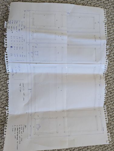

I'm looking to do wainscoting full height to a 2250mm by 4480mm bedroom wall behind a bed head (it is a very low traffic area). The wall is double brick and plastered (float and white set), and has subsequently been painted about 2 years ago. The exterior leaf of bricks has been waterproofed and is texture coat rendered.

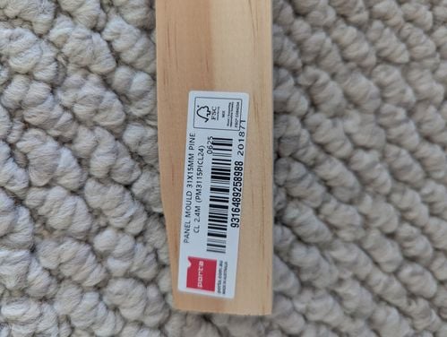

I've already purchased the pine mouldings (porta 31mm by 15mm) and have not yet started to prepare and cut them to size. I await the advice requested in this post first. Per the design that best suits the wall design the largest frame will be 1700mm by 1200mm.
I've looked at various online content for how to undertake this diy project but I'm struggling to see ones that have my scenario being the double brick masonry wall. I've since looked and other videos when installing more extensive paneling suggest battening out the wall. My initial thoughts though seem this may over engineer my application of such light decorative moulding.
In all videos I note the use of a nail gun. Is the nail, pin gun able to be used on masonry? Therefore my main queries centre more around affixing to the masonry wall in the most effective and efficient manner. Happy also to receive any further tips on completing this project nicely as well.
Thanks for any assistance and feedback. I attach a markup of the drawings, the pine moulding product number, and a inspiration pic of what I'm trying to achieve.
