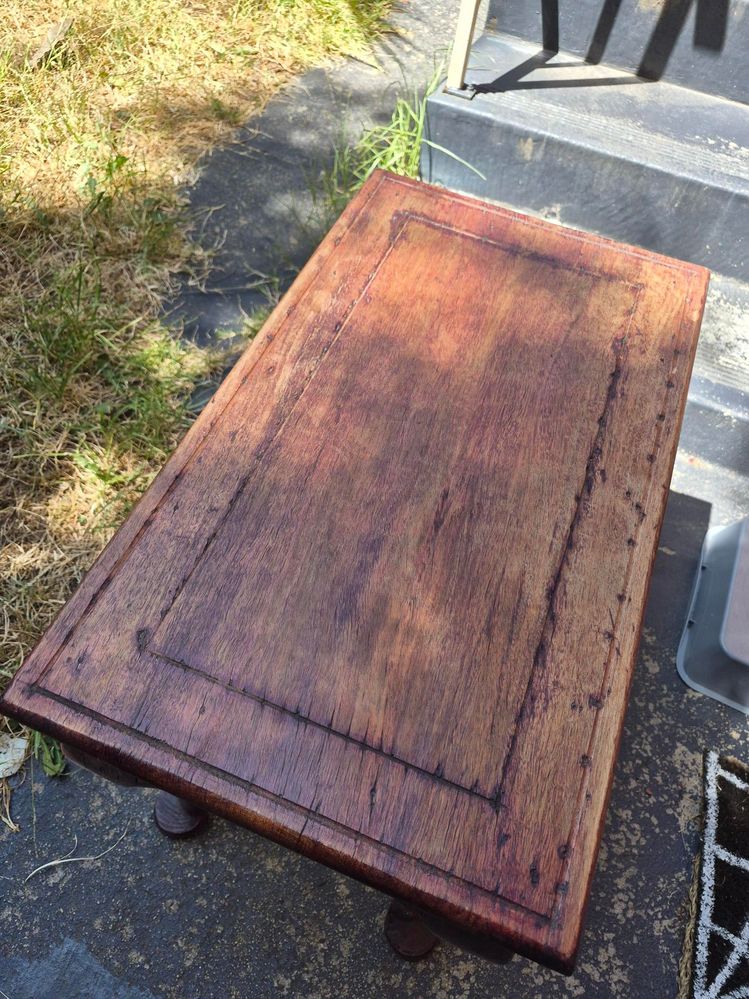

Inspected the piano stool for damage and loose joints

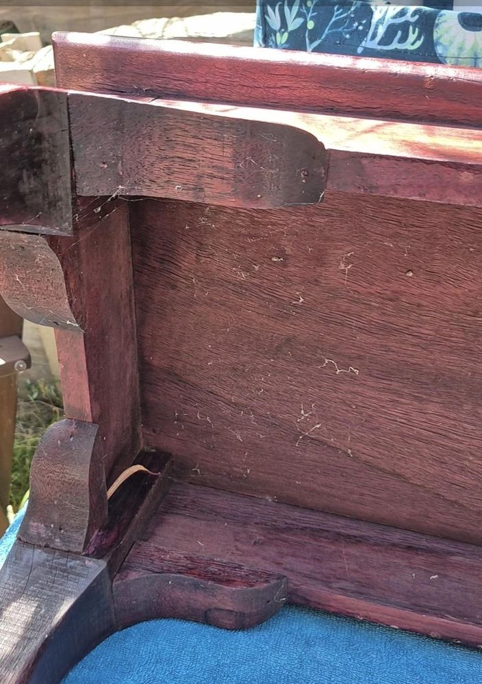

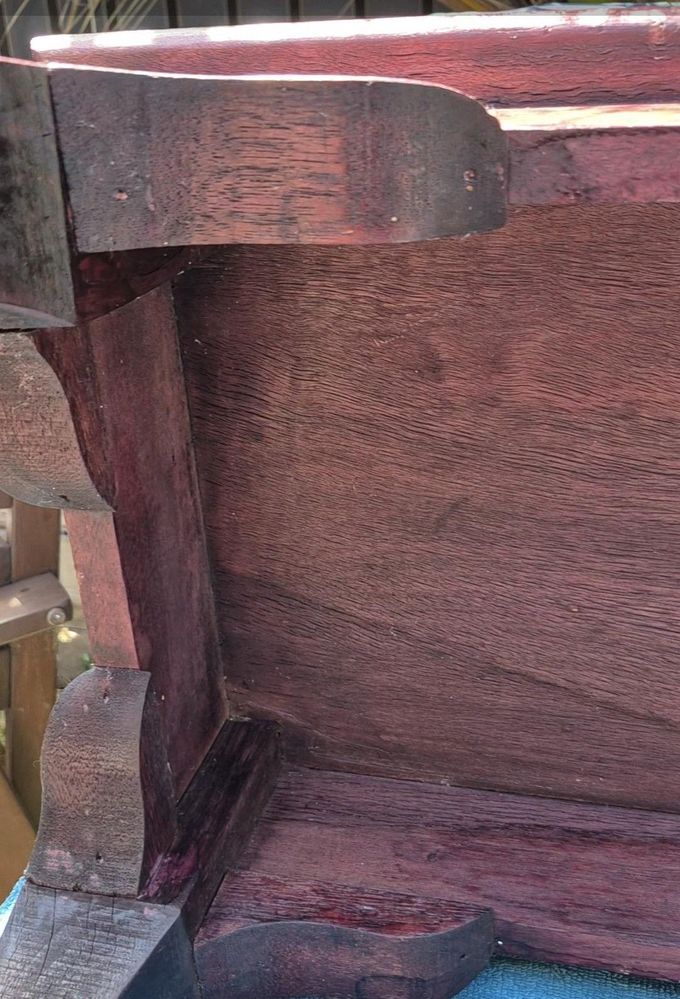

Turned the piece upside down to check condition

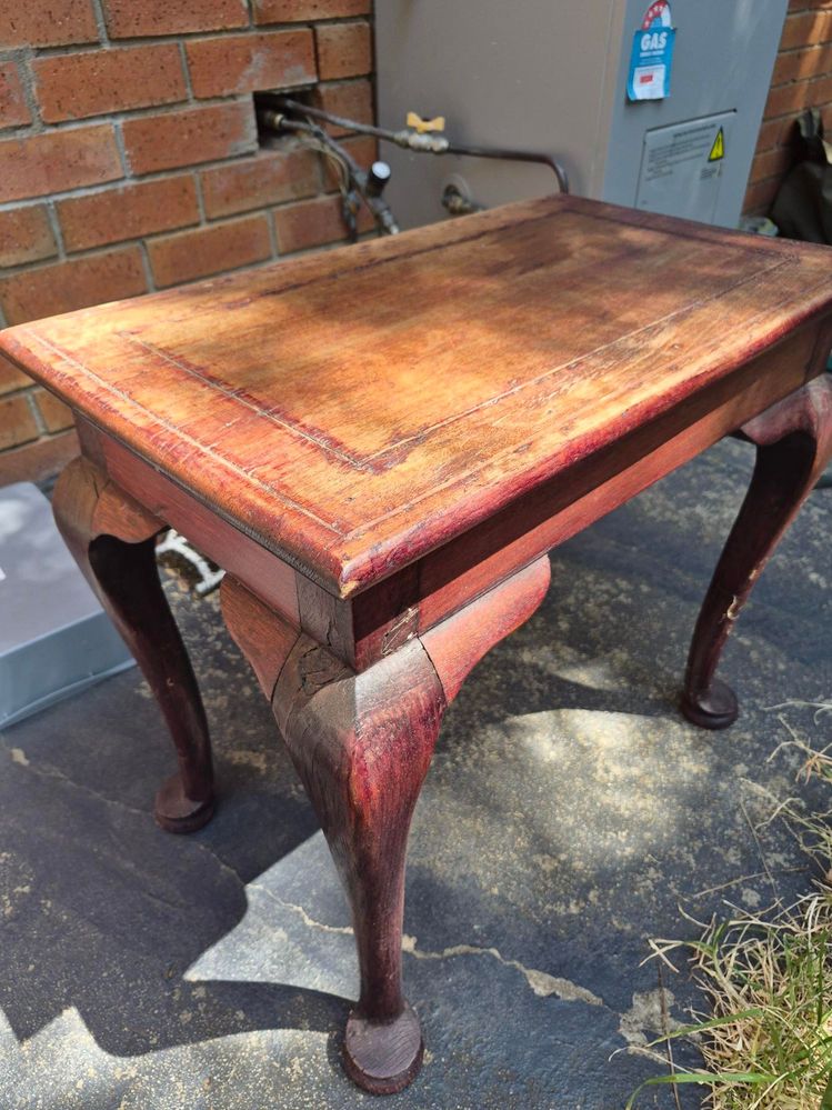

Gently cleaned the timber surface using a fresh microfibre cloth

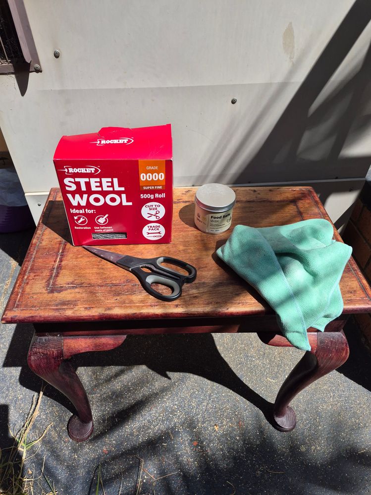

Gathered supplies
Step 5
- Applied a small amount of beeswax with a cloth, working with the grain
- Let the beeswax absorb for several minutes
- Buffed the surface with a clean, dry cloth
- Repeated waxing on dry areas where needed
