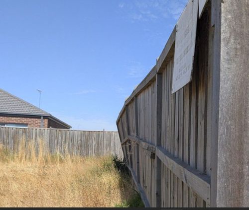

Because of the wind, our fence has been leaning out too much. Not quite sure how to fix it. Any suggestions?

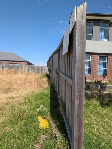

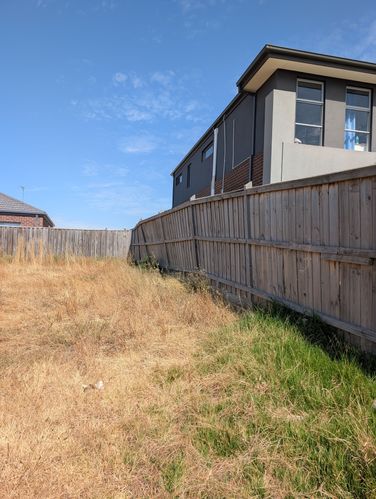

Th thank you for the response.It's not the entire fence. We share the fence with 2 neighbours. It has begun to lean after one of the neighbour's part is done, into the one where there is empty lot. I'm adding additional photos from front.
From what you’ve shown in the photos, it looks like this lean is beyond a simple “prop it up” fix. When a fence is leaning that heavily, it usually means multiple posts and their footings have failed or shifted. In your case, the wind may have started the lean, but the underlying problem is that the posts and concrete footings aren’t holding in the soil. Once one post moves, it puts extra stress on the neighbouring posts, so the lean quickly spreads along the fence line.
At this point, the most practical approach is to remove the affected section and rebuild it properly. This means digging out the old posts, making sure the new post holes are deep enough and set in good concrete footings, then reattaching the fence panels. You might be able to save the sections that are still straight, but anything showing a significant lean or twisted footings is unlikely to be stable without full replacement.
It’s worth getting a couple of fencing contractors to quote, because they can assess exactly how many posts need replacing and ensure the new section is installed correctly, so it won’t lean again. While it’s tempting to try temporary braces, for a severe lean like yours, that’s mostly a short-term solution and may just make the problem worse.
Yes... that needs a prompt response to stabilize that area of the fence.
Personally I consider that a emergency repair job and would make (if needed) a token effort (short timeline important) to contact who might be involved and if no response within a week I would proceed to 'make safe' that section of the fence with long star pickets braced with shorter pickets. That is a temporary fix and you should continue to make enquires about proper repairs.
