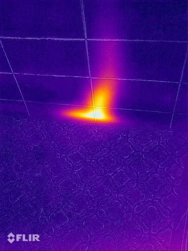

Currently, we’re only using cold water and there is no apparent leak. This morning, we ran hot water from the bath to fill a bucket and took a thermal image inside the shower wall, at the junction in the pipe that runs to the bath and up to the breech.
My question is: does this thermal image look typical when taken immediately after running hot water, or could the hot spot indicate a potential leak at that joint? This area also aligns with where moisture comes through the concrete into the hallway. For scale the wall tiles in the image are approx. 100x200mm.
