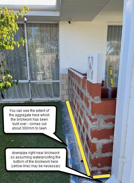

I have a query hoping someone can assist with - I have completed the brickwork for an outdoor kitchen project using standard maxi's which I have built over our existing honed aggregate (as a footing) under our alfresco. I am going to render most of the project then cover in a texture product like Dulux's Acratex. My question is do I need to apply waterproofing to the bottom half coarse given they are built over our aggregate (100mm thick and 2.5 years old - have never had any rising damp in the alfresco that I am aware of as it is also under the main roof), and if so, can I use my left over Davco K10plus or is there a more suitable brush on product.
The second question is if I need to brush on a waterproofing membrane, can I render over it (was looking to use Dulux p400 as base render however given that's over $40 a bag, am open to other pre-mixed render product which are water repellant and can be screeded over a waterproofing membrane (Davco PM render?, Westbuild Render+?)
Attached are some pics and you can see the extent of roof cover - the main back wall with the LPG gas drawer is the only area which can get wet in winter from rain when a SW rain, hence the question around waterproofing membrane on the lower coarse and an acrylic style render to repel water.

weather exposed area & downpipe
