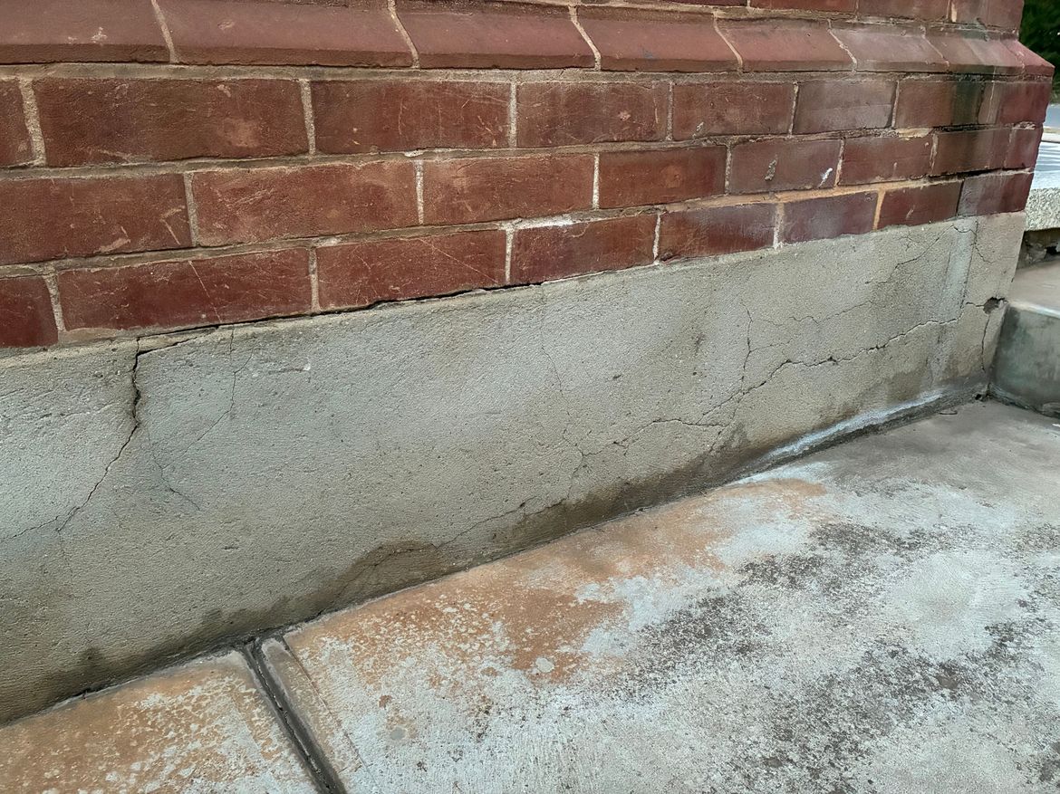

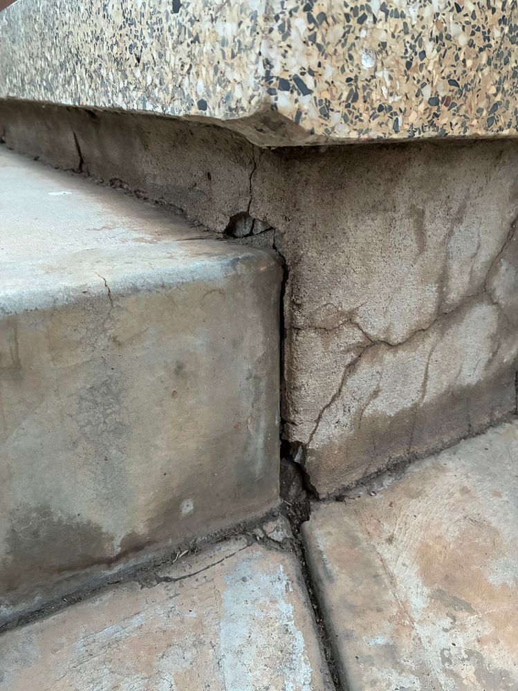

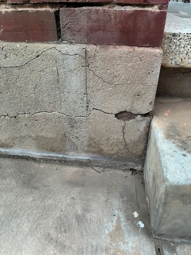

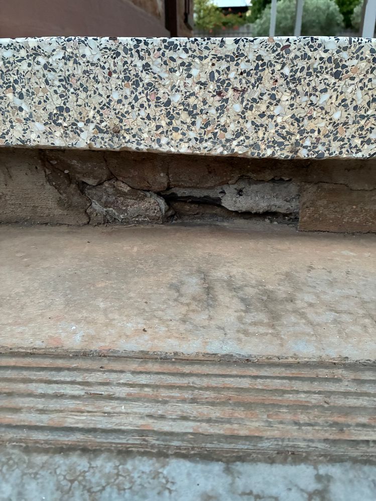

I have an old 1910 cottage that is in pretty good nick but the cement rendering on one side of the house is a bit cracked & broken in some places. I've added a couple photos to highlight the condition, but it's clear some of the render has separated from the material inside the foundation as it has a hollow sound when tapped on.
What is the best process for repairing the cracks and larger missing pieces?
Should I pull away a whole section of the render that is hollow and use some sort of structural repair mortar to fix it?
I would like to complete a long-term repair that will maintain the render for the future.
For context:
- The previous owners (I assume was for some time) had the down-pipe draining directly into the corner between the render and the step, which I assume is why this area has seen the most significant degradation due to the consistent moisture exposure. I have now rerouted the down-pipe so this area is no longer exposed to as much moisture.
- The area in the photos is ESE facing and gets most of the morning sun. It is otherwise out in the open (no roof etc.).
- The foundation is typical of a 1910 cottage - brick and wood (which you can see a bit of in the first photo).
