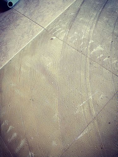

Hi, we are replacing our vinyl floor tiles with vinyl plank flooring this weekend. We have removed the old tiles but wanting some advice on the easiest way to remove all of the adhesive/glue beforehand. Thanks

Fun Job you have there Tania87! , i would give a heat gun a try with a decent scraper that doesn't flex to much , sanding will do it to but your pads will clog quickly
Welcome to the Workshop community @tania87 , it’s great to have you join us. Many thanks for your question – I’m sure this is a common challenge.
My advice would be to begin by removing as much glue as possible with a scraper. Some options to make life easier include a Heavy Duty Floor Scraper and Floor and Wall Scraper.
Depending on how old the glue is you may find it necessary to apply heat. This product would be suitable - Ryobi Corded Heat Gun. Apply the heat over a 30cm x 30cm patch for one minute, then try scraping the glue in that area.
If you find it hard to remove with heat, a chemical softening agent would assist in breaking down the glue. Acetone Cleaning Solvent could be used. Apply to a small area, wait for five minutes then attempt to scrape the glue off. Remember that when using solvents it is advisable to wear chemical gloves, respirator and eye protection, as well as ventilating the room as much as possible.
If the glue is still stubborn, another option would be to hire a floor sander and utilise a coarse grit sandpaper. As @wooshka suggested, the sandpaper will clog up quickly. I would advise 40-80 grit sand paper to avoid heavy clogging and excessive use of pads.
