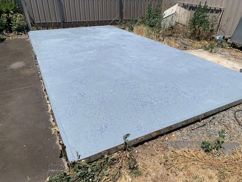

Since the old concrete slab was in good condition and fairly clean, I decided to epoxy the floor. Figured while there were no walls, and lots of fresh air, now would be a good time to do it. Following the directions, I etched the slab, and applied a coat of epoxy.
It looked great when it was done, but a few months later it was looking a bit dull and blotchy. In hindsight, I think I'd do one heavy coat at the end.

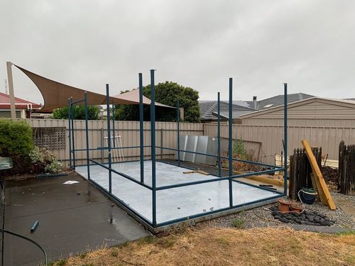

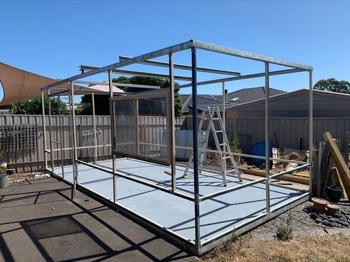

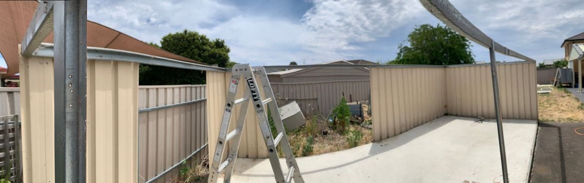

Next, with the assistance of a few friends and a welder, we bought around 70m of 40x40mm square tube and set about first kitting up all the parts we'd need for the new framework, then assembling it all on site.
By this time, our original "build a box" plan had evolved into something more complex. We decided to shorten the doors, because leaving them full height (as they were originally) would make them too tall when it came to reaching the pad bolt at the top of the second door. We also decided to add additional structure to the corners and along each side to both reinforce and give us something to hold the roof up without relying on the wall panels.
The gap between the middle rail and the floor is the roughly 600mm of height that we added. The welds were all cold galved, and the visible portions of the frame painted to match the paperbark coloured sheets that would go on later. The door frames went back on to check fitment (we used the original frames, and added roughly 300mm to the height). We also reinstalled the window, both to check fitment, and because I didn't want it to get broken laying flat on the lawn. You can see the original roof framework was re-used as is.

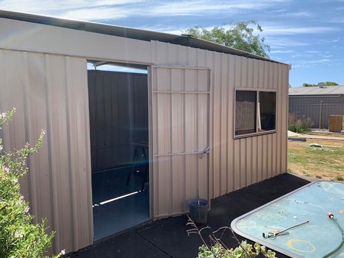

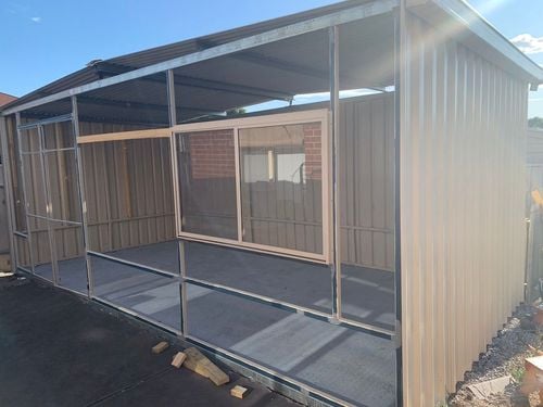

Next up, make it look like a shed again! We bought brand new, 2.4m sheeting for the two most visible sides (towards the house and lawn), so that they'd have a nice clean look. The old sheets from those two sides were cut into 600mm "mini sheets", used to fill the gap when the original sheets were re-hung on the back and fence sides. Since those sides aren't really visible you don't notice the join, and we saved a fair bit of money by buying new sheets for only half of the shed. We started on the short, simple side (closest to the lawn), the worked along the back, and down the fence. Leaving the front (with doors and windows) for last.
I also installed brackets and timber studs for peg board and tool storage into the framework before we sheeted each wall. Having access from both sides of the frame made drilling and screwing the brackets into the steel much easier than working against a steel sheet.
The roof, ridge capping and gutters went back on without a lot of drama. Everything was labeled, and went back exactly where it came from.
Putting the door skins back on the door frames was a challenge. A large sheet metal brake to bend the sheets around the frame would have made the job much easier. But we got by with clamps, brute force, a rubber mallet and some swearing. We had a flat flashing panel custom made to the right dimensions to go above the door and create a lip so that water would drip and run down the back of the doors.

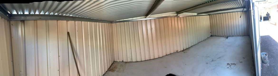

After that it was all finishing work. The original design had the wall sheets fitting together nicely and screwed at the corners. But subtle changes in fitment and dimensions meant we couldn't easily do that on the new version. So the final flute in each sheet was lopped off with the grinder and new flashing installed on each corner to cover the cuts. The original flashing was reinstalled to cover the peak in the roof. Downpipes were reinstalled, and the rain water tank put back into place. We still need to plumb it in properly, the added height means we need to add a short length of pipe, as the outlet is about 600mm above the tank. We also pinned the concrete slab with star pickets, built a retaining wall, and barrowed in about a tonne of road base to try and stop the slab escaping down hill again.
The original epoxy job on the floor was either applied too thin, or didn't like being in the summer sun for a few months (probably both), and was looking a bit patchy. It was ok, but we did have enough un-mixed epoxy left over that we could do a second coat. This was applied much thicker, and looks great. It's got that real smooth sheen you see in a professional workshop.

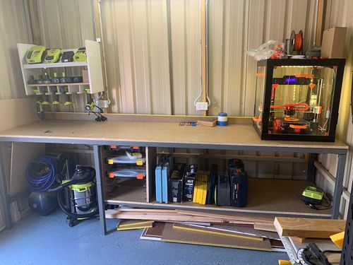

During the build, we'd had a couple of wet weekends where I couldn't work on the shed proper. So I'd built a 3m workbench out of the left over steel from the frame. To go along the short side of the shed inside the door. We cut bench tops, and fitted those place. My cordless drill station was finally hung. The electrician came back, reconnected power, and installed additional power points and lights. We built shelves, and moved everything back in.
So, I don't hit my head on the roof any more (although I do still duck going through the door, old habits die hard). New shelving lets us make much better use of the space we have. Nothing lives on the floor any more, and I've got some actual workspace for projects. Project: Shed 2020 is a great success!

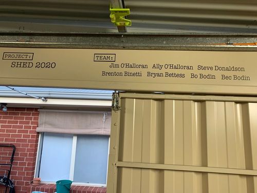

All that's left is to ask my wife to break out the vinyl cutter and acknowledge the great friends who helped make this build possible...

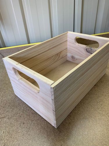

And build some stuff...
