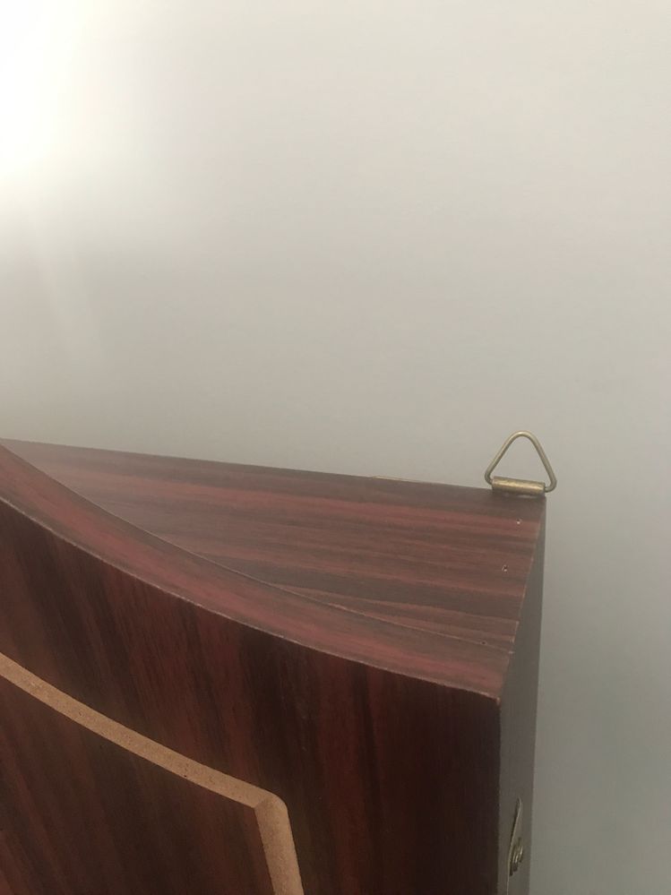

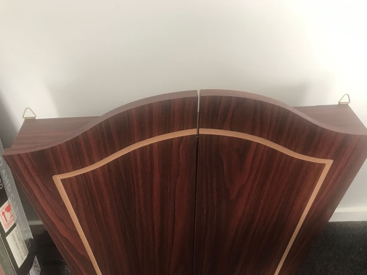

Looking for some simple handy man advice - I'm looking to affix a dart board and wooden cabinet to an outside hebel wall.
All up it weighs about 10kg and there are 2 x hooks / fixing points.
Any suggestions on what type of screws I need?
Thanks

Hi @AaronGuthrie. My apologies, I interpreted your question as you had hooks.
These Zenith 98 x 6mm Zinc Plated Ceiling Hooks should work in that circumstance.
I hope that assists and please do let us know once you have hung the board.
Actually, now that I've looked at the Eye Bolts I might need something slightly different as I have 'eyes' on the board, so need more of a hook on the end of the bolt (see pics)
Great thanks Mitchell. I can confirm that it is rendered Hebel (CSR) so I'll give the Zenith bolts a go.
Much appreciated.
Welcome to the Workshop community @AaronGuthrie. Thanks for your question, I'd be happy to assist with it.
I'd just like to confirm with you it is Hebel and not Besser block? Hebel is a soft material which expansion bolts are likely to crack. I would advise pre-drilling holes, then securing Zenith 6 x 100 x 14mm Galvanised Eye Bolts into them with Ramset Chemset Masonry Anchoring Adhesive Cartridge. Another cheaper alternative is to glue them in place with Selleys Liquid Nails Landscape, though it is not as strong as the Ramset product.
If they are Besser blocks, then a Ramset 8 x 45mm Dynabolt Eye Bolt will be sufficient.
If I can be of further assistance, please let me know.
