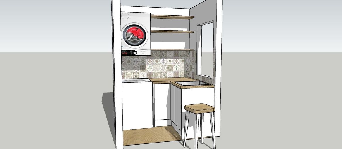

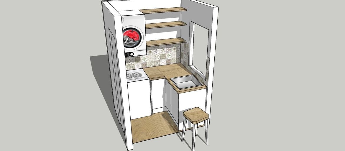

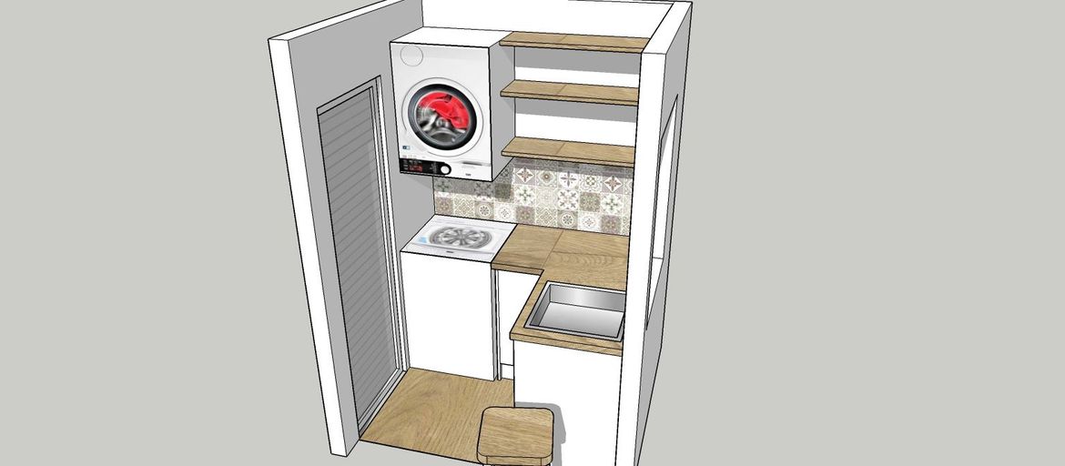

G'day Everyone,
A client recently asked me to draw her laundry to see if everything would fit and that it would look okay, even with both machines in such a small space. The space laid out is 1550 x 1360, using standard kaboodle flat pack cabinets it's possible to make it work. Although I believe some adjustments will have to be made to the base cabinets to make the sink fit. But other than that everything should be fine. A space of 610 mm has been allocated for the top loading washing machine which she was hesitant to part with ( nothing wrong with that, some people like their top loaders ). This is one of those times where space is at a premium and everything has to measured accurately to avoid mistakes on the build.
Cheers,
Red
