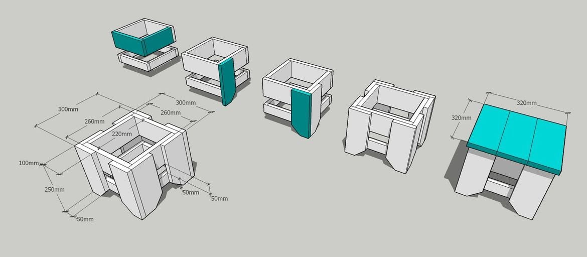

G'day Everyone,
My grandfather was forever making these things for my grandmother. Stools to sit on and doubles as a flower pot holder. This is great for left over palings and what ever timber might be lying around. This is a good starter project for those who want to start in woodworking, something that you can build and tear down and re-make. The measurements are a suggestion only, you can size it to your pots or leave it as is. When it comes to building it you can modify it as much as you need to, to suit your needs. Just like instructions from the flat pack systems, build it as you see it. Good luck and stay safe this weekend.
Cheers,
Red
