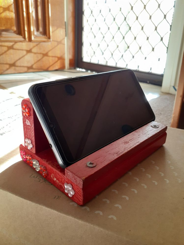

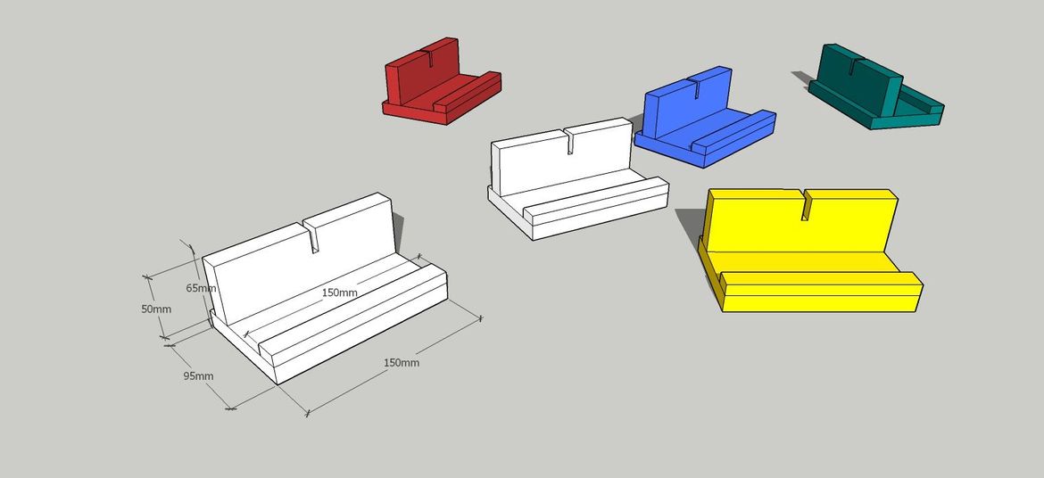

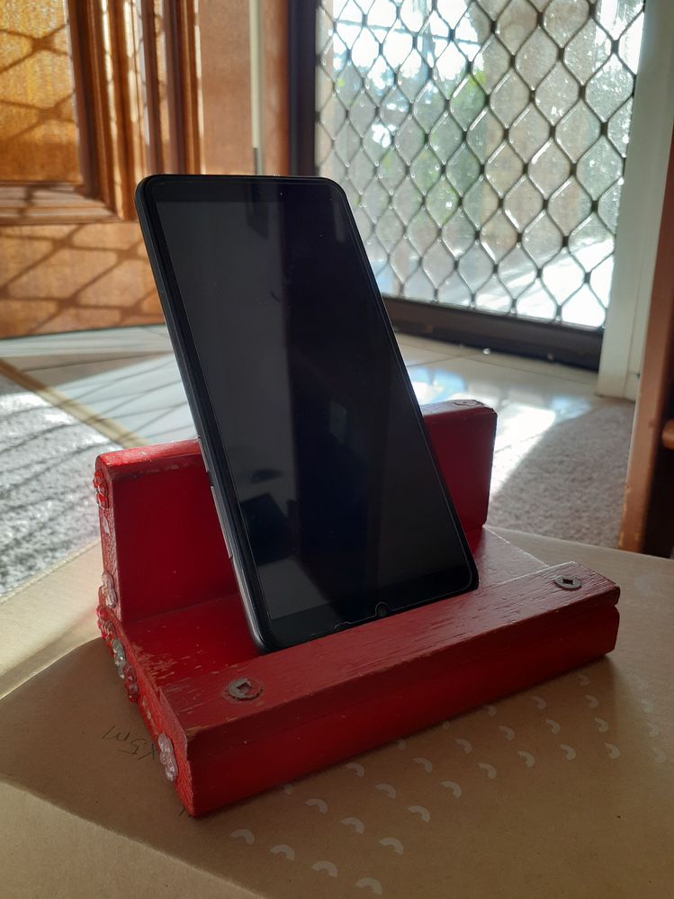

Today's weekend project is the perfect diy gift for your loved ones. I built these easy to make phone holders over a few days just before Christmas a few years ago. I wanted to make something that was really personal and be practical at the same time. You could do this in as little as 1 hour it's the paint drying part that takes forever. You can enhance it with what ever comes to mind do wood burning lettering, stencil with spray paint...etc the choice is endless. The main stand and the little stand are both screwed on but you can nail it if you wish. The entire assembly is made up of 3 pieces of timber. The only rule to the build is that the front timber that holds the phone in place must not be too tall or it will obscure the front of the phone when used as a viewing stand. Enjoy the weekend everyone and stay safe. Any questions please drop us a note here on Workshop.
