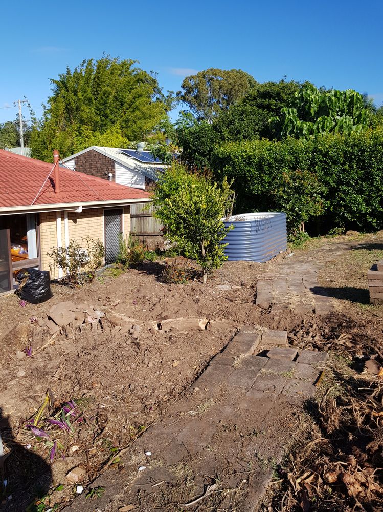

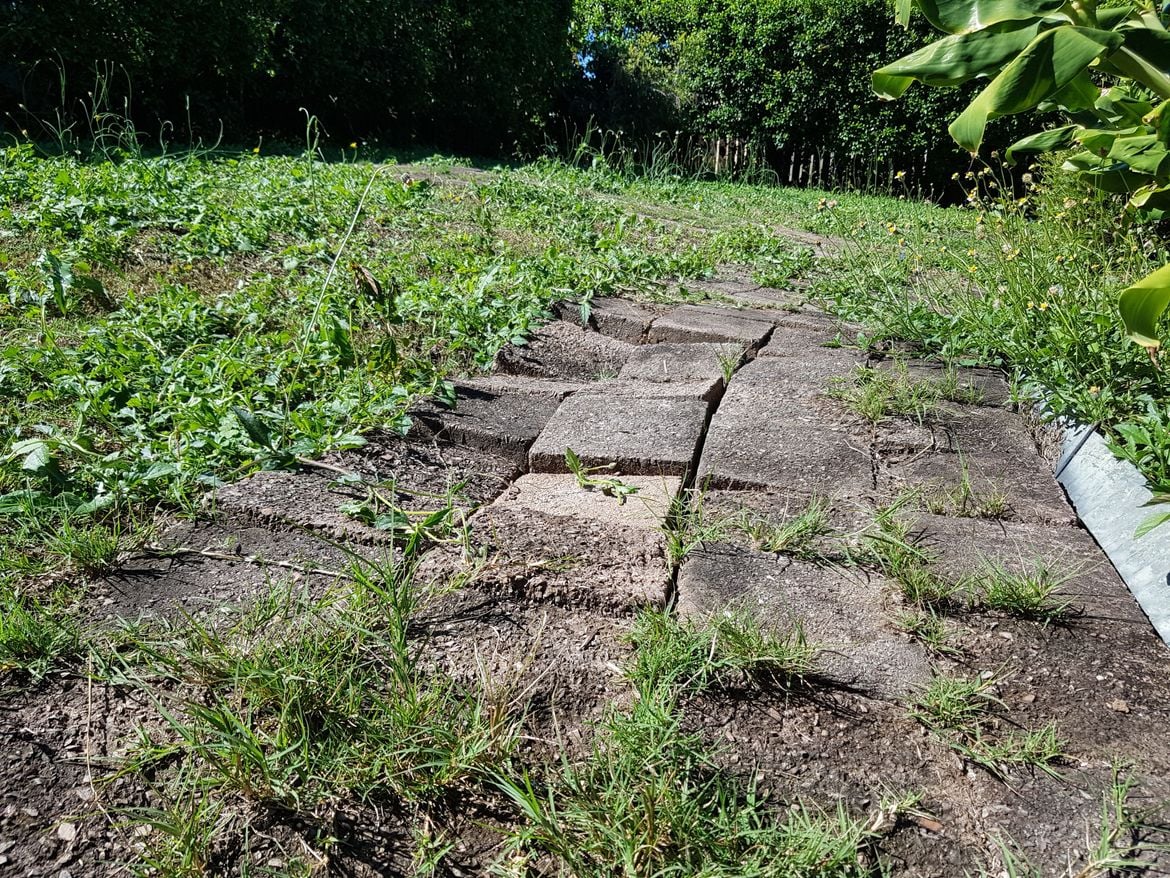

My questions relate to a big problem in the yard where the ground and parts of the paved path have sunk due to disintegrating tree roots. Some of the "holes" are up to 20 cm deep and the ground very soft and spongy.
I have pulled up pavers in the sunken areas back to level plus two more pavers, removed what roots I can of the old camphor laurel but some are still solid circa 20 - 30cm diameter and taking longer to chop out.
So my question is what do I fill the holes with before I put gravel and sand in to replace the pavers? Some of these go down 50-100 cm and I wondered if normal bagged garden soil would be too soft.
