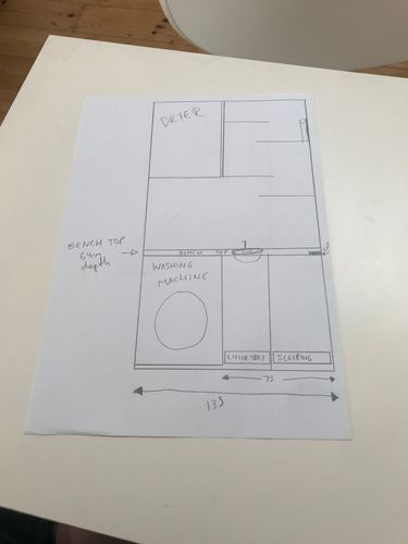

I've had the idea to better utilise this space, and make room for the cats' litter tray/food and sleeping/lounging/playing areas. During the day they have free run of the house but at night we like to put them away in their own space so they stay safe.

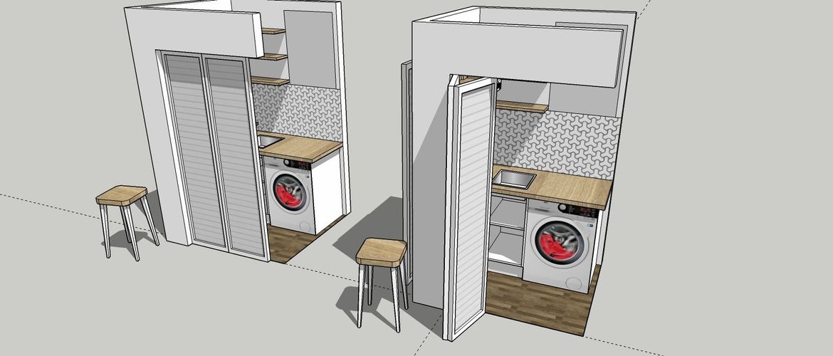

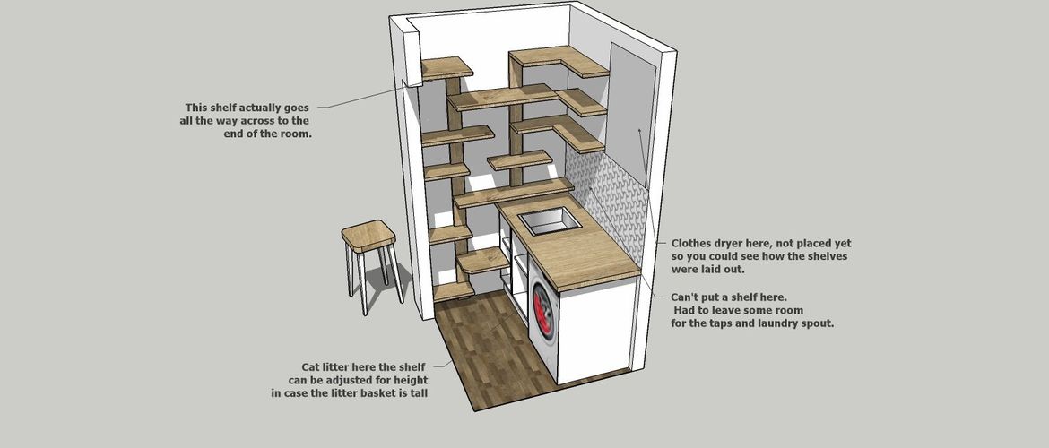

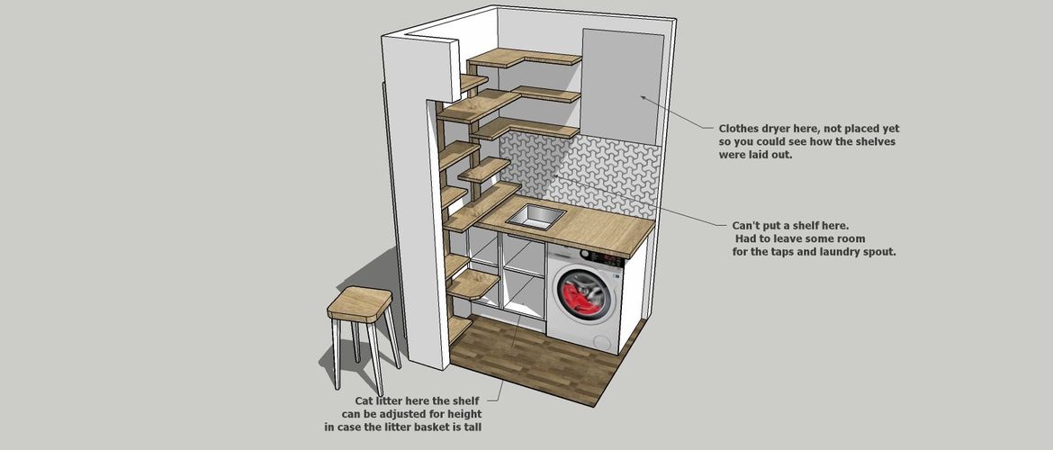

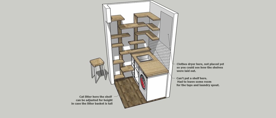

My rough idea is below...
- Take out the large laundry sink we now have, as we never use it.
- Move the washing machine to where the sink currently is
- Mount the dryer high up on the wall, leaving enough space for a bench top
- Put a slab of wood as a bench top
- Next to the washing machine, have some cupboards separated into two section, one for the litter tray, and one for the cat sleeping area. These would have normal cabinet doors on the front to allow for easy cleaning, with cat doors cut into them.
- Up above the bench, put in some open shelves, with gaps between them so the cats can jump up and play/lounge. I would add carpet tiles to these for traction and also a scratching post.
- Their food would go on the bench top (which I estimate to be about 64cm deep, based on the washing machine)
- Possibly a small sink in the middle of the bench, above the cavity where the litter would go (can you easily switch the position of the washing machine/sink with the help of a plumber?)
- Ideally, on the far right of the bench top we'd cut a hole in the bench so the cats can jump up from their sleeping area. Alternatively, I need to come up with an idea for them to jump from the floor up to the bench for their food (right now they have taken over our bathroom and jump from the toilet up onto the bench where their food is)
Finally, the nook area leaves a gap of about 30ish cms in front, and I am thinking of getting roller style wardrobe doors to seal off the space at night time.
