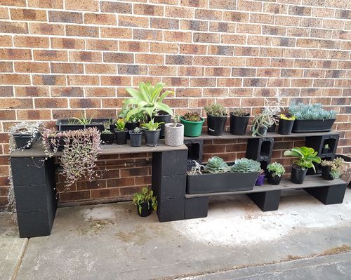

Thank you! I got the job done over the weekend 🙂
@EV77,
That looks fantastic and great colour choice! I like how modular Besser blocks are for making plant stands. If you want more room just add more blocks.
Many thanks for sharing your finished project with the community.

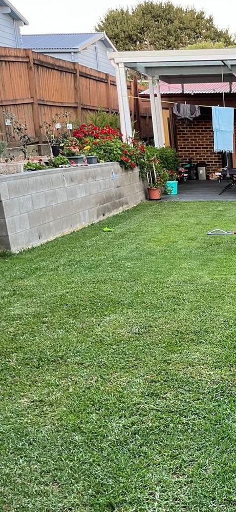

I have this retaining wall and would like to paint it. The concrete besser block has some white substance that leaks out.
If I paint over it will the paint hold? Do I need to use a primer.
what products do you recommend?
Note : the inside was waterproofed while this wall was built.

Welcome to the Bunnings Workshop community @EV77. It's wonderful to have you join us, and many thanks for your question about painting a retaining wall.
The Dulux Weathershield is self-priming and only needs to go onto a clean and sound surface. Give the wall a good brush down to remove any powdery cement.
The white substance is efflorescence, a crystalline deposit of salts that can form when water is present on or in cement work. It would be good insurance to first paint the wall with Dunlop 4L Damp-Proof Waterproofing to ensure any moisture within the wall doesn't push the paint off through negative hydrostatic pressure. It also prevents efflorescence.
