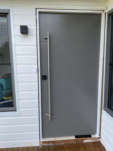

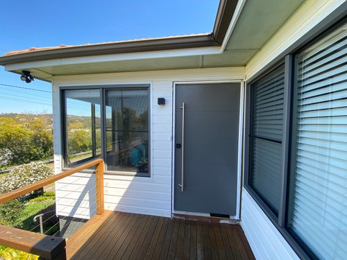

Here is the final product (sort of). The floor tiles aren't complete yet, as well as the internal architraves, and external trims. The external trim will match the white trim around the adjacent window. (Also, the block floor box has a stainless steel cover that sits over it once the floor tiles are in place)

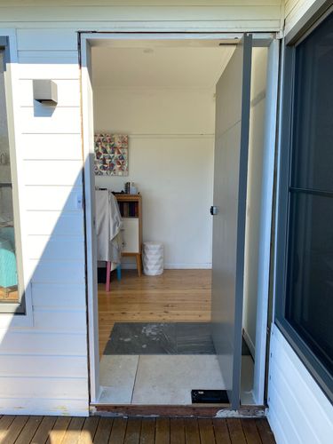

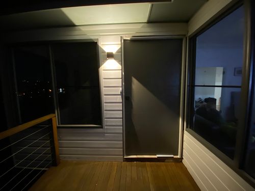

I looks nice at night too, with the up/down light. - I'll get a different doorbell, once I've done the trims, and position the door bell under the light. Here is a photo at night, as well as a photo showing the pivot style, in the open position.

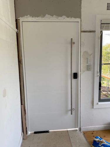

I decided to paint the internal face of the door white, to match the internal walls, and the external colour matches the aluminium windows ("Colorbond Wallaby").. A nice feature is the electronic "Ultraloq" - which has fingerprint scanning, as well as a PIN code. I was worried about how that would look (ie: a little bit over-the-top), but it actually looks and works quite nicely.
The challenges that remain, is deciding what to do with the floor tiles, and the vertical face of the threshold (on the outside).. (You can see the grey colour of the large floor tile in the last photo).. One option is to carry the floor tiles all the way out, and turn them down the face, or alternatively, I can cut one of the white weatherboards and install it back under the door threshold, with just an aluminium nosing or something to finish off the floor tiles at the leading edge..
