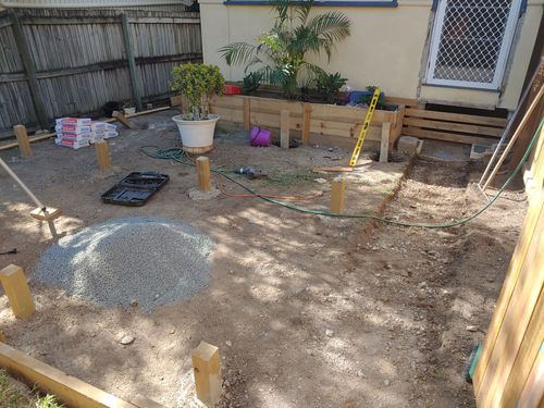

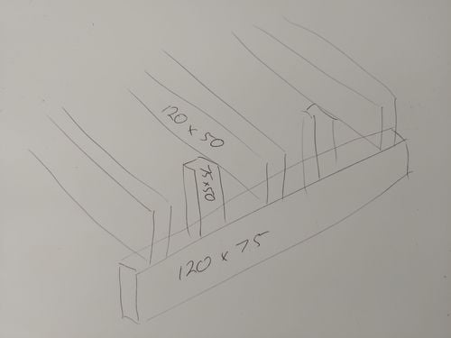

I'm after some advice for mounting a ledger. It's an old hardwood house and doesn't appear to have any rim joists.
The beams are 120x75 and joists are 120x50. There are 75x50 studs in between each joist. For height reasons I want to use a 190x45 ledger. How best to attach this? Can it just be attached to the beam? Can it be attached to the beam and studs? Or should I add some blocking between the joists to allow attachment up higher?
The other option is to sink posts 300mm off the house and allow a cantilever. This would also negate the need for any waterproofing. I've attached a very dodgy hand drawing just for a visual.
