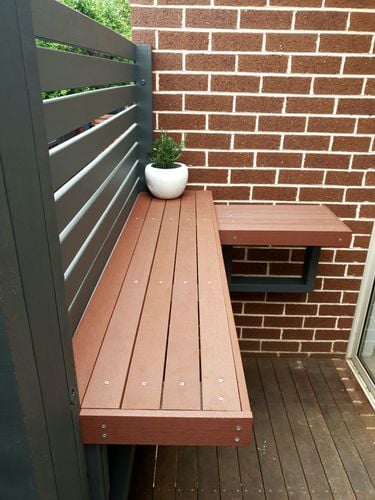

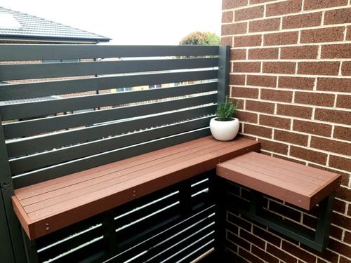

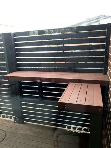

Worked on our outdoor breakfast bar this weekend. Here is the final result and a few progress shots to show how I created it. Time to get some stools!

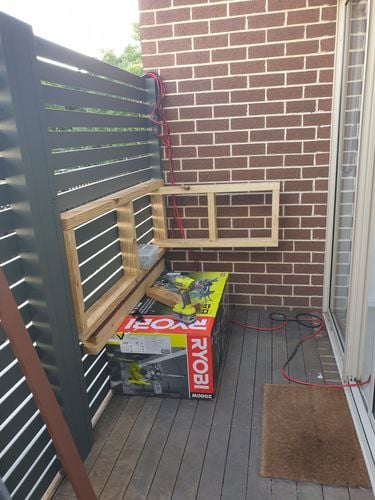

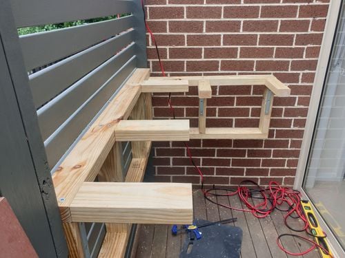

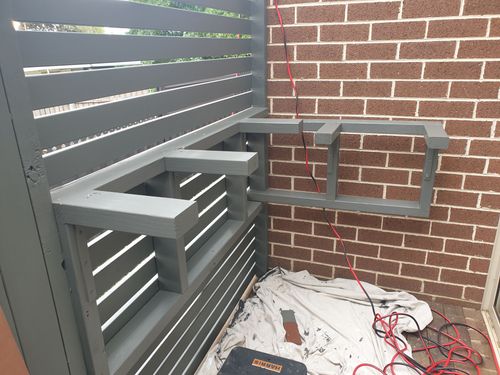

I used the existing columns of the patio to carry the larger weight load from the new main frame which I built inbetween the columns.
After

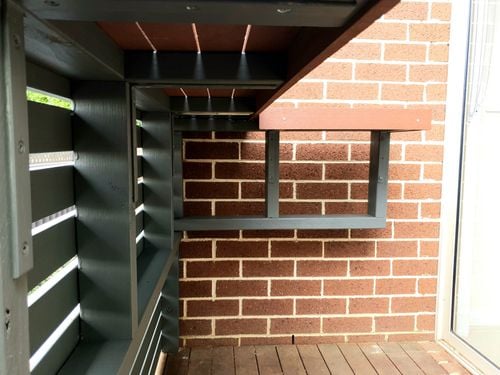

I then built the secondary cantilevered frame into the main frame, which I stepped down for some visual interest.
We had painted the screening panels Woodland grey (previous project) which we used again on the bar frame to blend in into the rest of the structure.
I used Ekodeck composite cladding and framed it with some 90x45 and used some angle brackets to float the actual platforms.

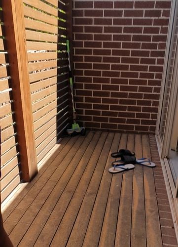

Before
