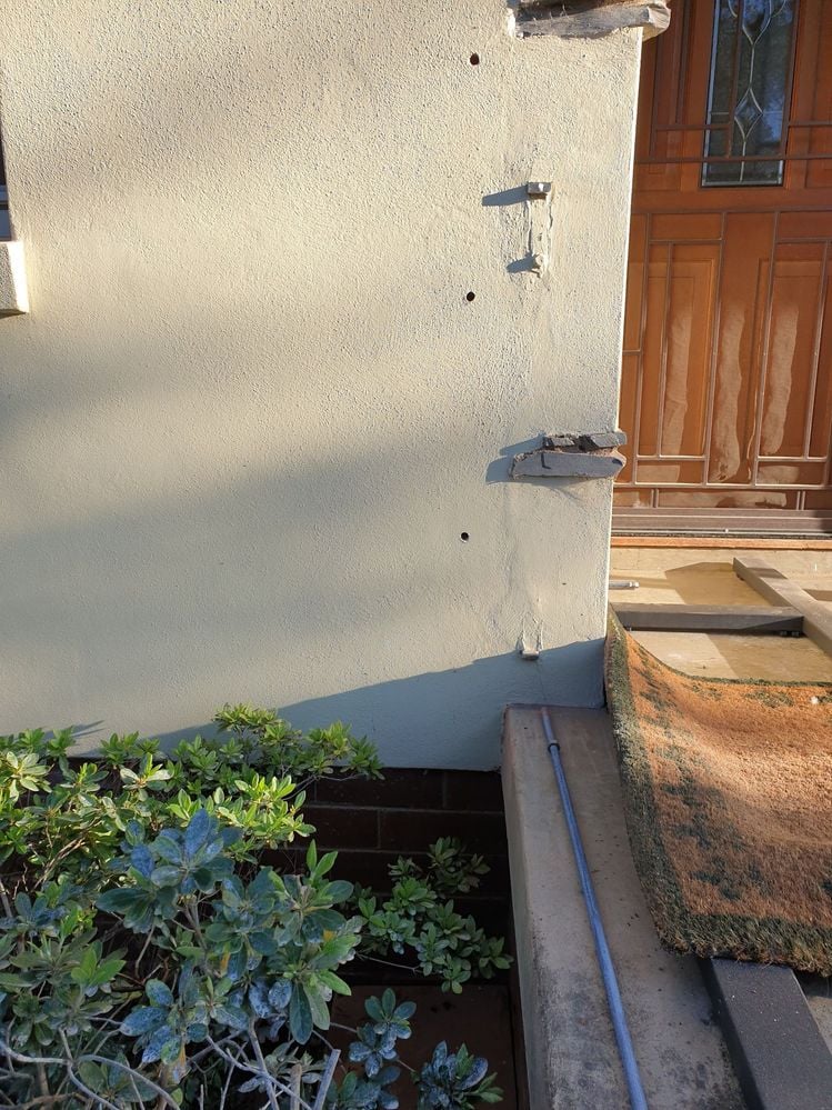

Hello, wanting to attach a 125x125mm spotted gum post to this wall, holes are already drilled. The bricks are 110 thick and the post is going to be for balustrade only (wire) I was thinking of using 12mm threaded rod with chemset 101 but the specs on the chemset don't seem to explain if this is possible? Surely this would be a common use case for this stuff? Load will be sheer for the post and pulling out for the balustrade wire. Going to fill hole with chemset, place 110mm of rod into it, twist it etc than let them set and mount the 125mm thick post onto them then bolt them all up.
