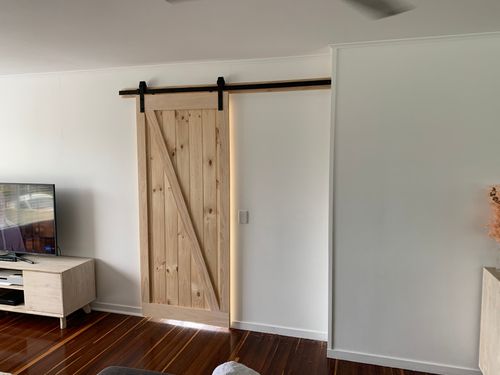

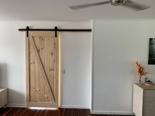

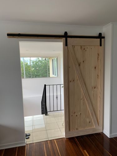

Recently completed a sliding barn door. This was needed to shield our living room from the harsh Afternoon sun, beaming in through western facing windows. The door also helps to partition the living area from the front stairs and helps the air conditioners run more efficiently.
This project was completed using 7 pine lining boards and lengths of 89x19mm and 140 x 19mm dressed pine.
The door track kit is a rolltrak barn door system.
A dressed pine headboard was used to secure the door track to the studs in the wall as the pre drilled holes in the track did not quite line up with the studs when the track was in position.
