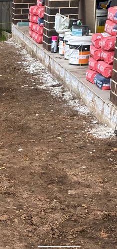

Is it allowed to fix deck ledger board into the edge of concrete as shown in the picture so as to eliminate concrete posts. In this case joist will be spanning from that ledger board to post on the opposite side. I took out the tiles at the edge and found the concrete is in good condition.
