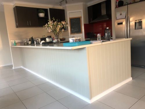

We recently updated our kitchen bench with feature board

We used the easy craft 9mm feature panel boards.
Before installing I lightly sanded the veneer on the kitchen facia to take the polish off and help the glue stick.
The board’s were also bradded on. 9mm feature panel+16mm facia board+18mm cupboard backboard gave me heaps of space to not worry about a 32mm brad coming through into any cupboards or draws.I still double checked for the pipe work leading to the sink and dishwasher.
Added skirting after painting and made a small piece of corner moulding from dome off cuts of the panel board.
to make installation easy your panels can be 5mm short +/- and this gap will be at the bottom then covered by your skirting
