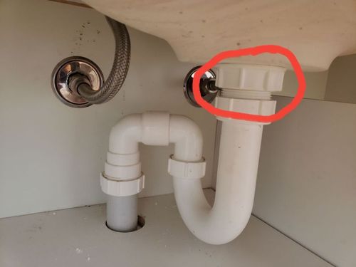

Hi all
I'm doing a cosmetic makeover of my ensuite and going to replace the vanity top that has a built in sink to a merbau laminated panel with a basin that sits on top. My problem is that the waste pipe will be too short by about 200mm. Probably a dumb question, but can I buy an extender or something similar, or do I need to replace the entire waste pipe with a longer one?
Thanks!
