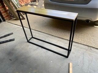

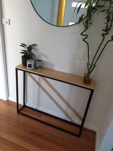

My beautiful best friend asked if I could build her a table for their new home. She found one online and asked if I could replicate it but to suit the size and style of their house. It was great trying something new (as I had never used metal for the main base). She was so thankful and absolutely loves it!

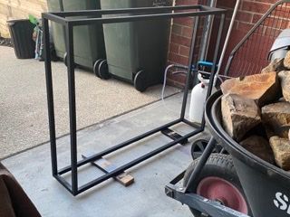

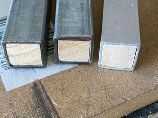

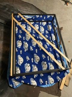

I used galvanised square metal poles, which a hollow. So to help add stability and make it easier to join I purchased timber posts and cut them down so I could insert inside the poles. Was a bit fiddly but really worked a treat!! I pre drilled the holes for the screws and made sure to countersink so that they were all flush. I used matt black spray paint. For the table top I used spec rite utility pine panel. Cut to size, sanded and stained clear. I added to lengths of pine mouldings to the rear to assist with minor movement and also add a special feature.
