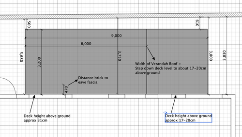

We're in the process of getting a quote through Softwoods which we saw on Bunnings for a deck + verandah which we can then DIY. Unfortunately our council requires a building permit for any size of deck in Victoria, so it's quite a process to get this deck. I did find a company that will do the drafting and get the permit across in one service which is good.

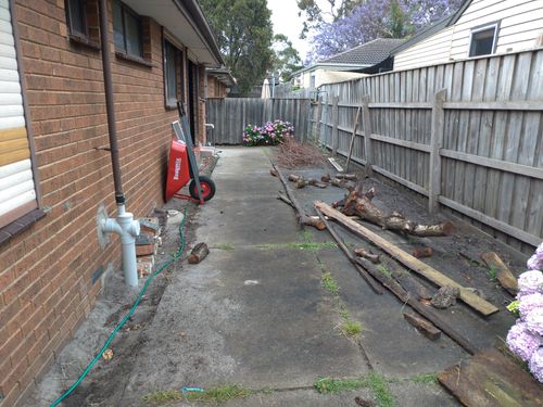

But wondering if there's maybe any better ideas? Right now, it's just an ugly concrete slab! My wife also isn't a fan of pavers.

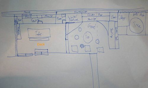

We're currently thinking of a 9m deck with a 6m verandah for the first bit. The deck will be in line with the sliding door at the end, around 31cm above the ground. At the 6m mark (end of the verandah), I'm think of doing a step down to around 17-20cm height just to break it up a bit and give it different levels. Or maybe at the 6.5m or 7m mark?
At the 9m mark, I'm thinking to put a few cm of coarse gravel
and putting a few logs as seating and a little firepit.

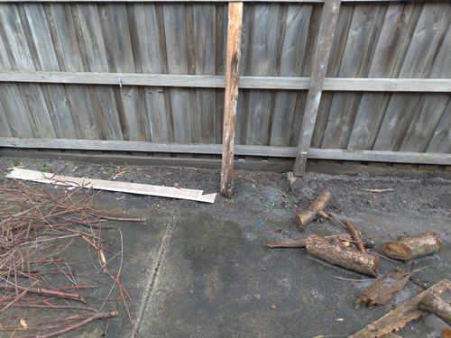

Along the fence, around 50cm deep I'm looking at running raised garden beds and screens. The fence will be replaced with a colourbond fence.
This photo shows the 9m to the end of the sliding door

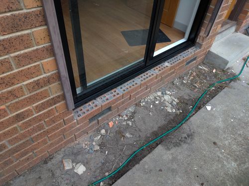

Newly installed sliding door, deck will butt up to door
Sand between concrete and fence
Am keen to put in a built in BBQ, where might I put that in this layout. The left side of the deck above, I'm planning to put some screening so at to block it off from the laundry area. I may just leave the last 0.9m of the deck and put a ramp there to get lawn mower through from the garage.
