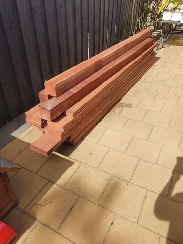

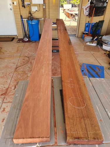

The green timber from Austim (jarrah).

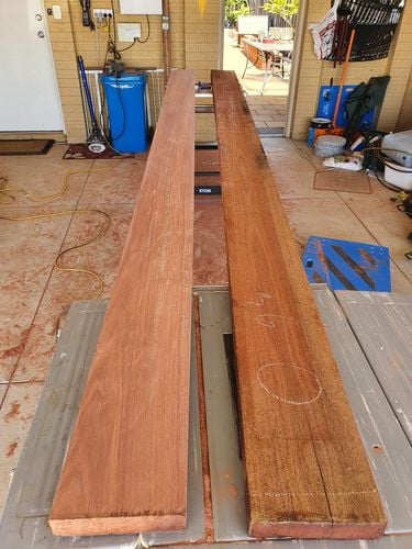

Planed and sanded cuts.

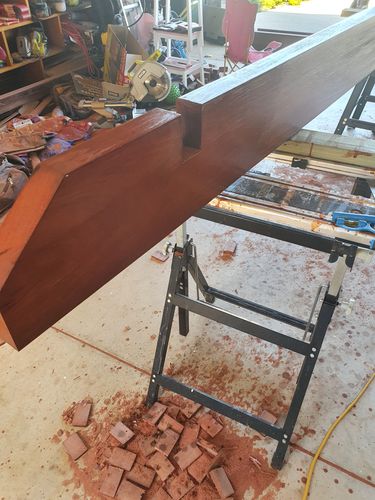

Aquadeck jarrah decking oil applied (after Cabot's timber prep) and slot notches jigsawed and chiselled out.

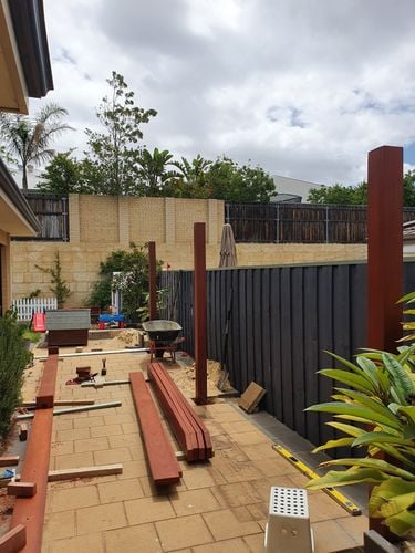

Main support posts cemented in.

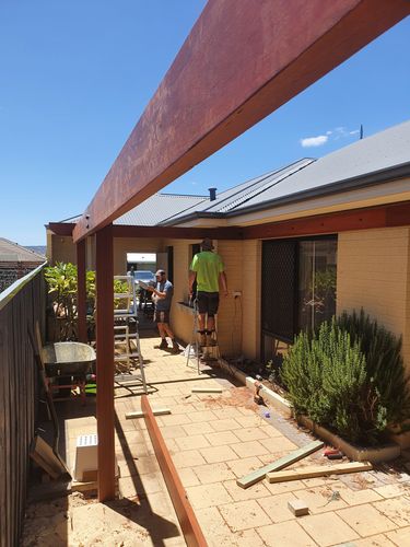

Horizontal supports beams erected, with house side beams dyna-bolted into brickwork (tip - pre-drill and measure prior to inserting so you don't have to physically hold heavy jarrah beams in place whilst drilling pilot holes etc..).

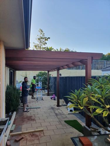

Last of the cross-beams going up with help from neighbours (thanks boys!)

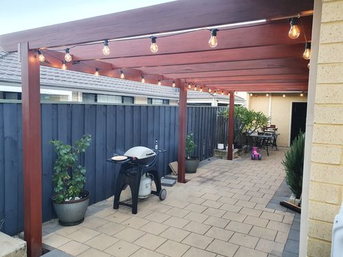

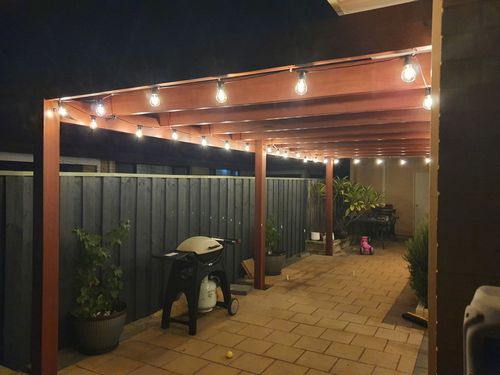

Installed some festoon lights as well to give it an special effect at night
95% complete with just the wires to add and a final tidy up with the paving.
