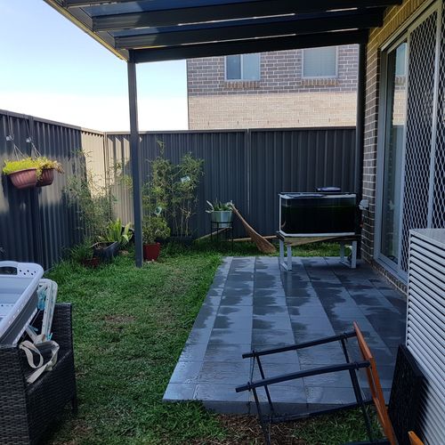

I'm planning to DIY floor decking at my backyard. Area will be approximately 5.5 x 3.5m.
Here are some facts and obstacles (for me).
1. There's an existing patio with tiles on them which is 4.8 x 1.2m.

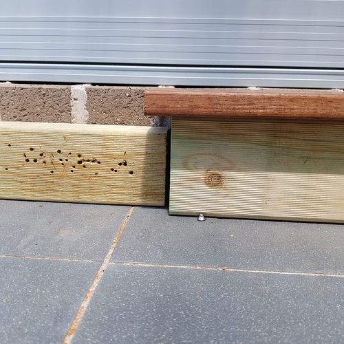

2. The patio have a clearance of only 110mm to the house brick level.
3. There's an airconditioning unit next to existing patio with a size of 140 x 77m
4. Two posts near the fence for the pergola.
Here's a few questions for now:
1. If I'm using a composite decking, what will be the size of the timber for my joist structure and the distance?
2. Is using a tuffblock better and cheaper or is there a quick/better solution than cementing a post?
Hope to get some good recommendations from you guys.
