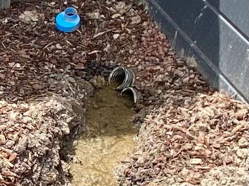

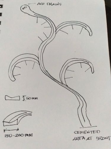

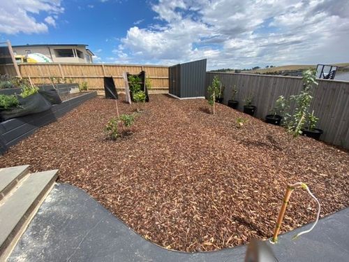

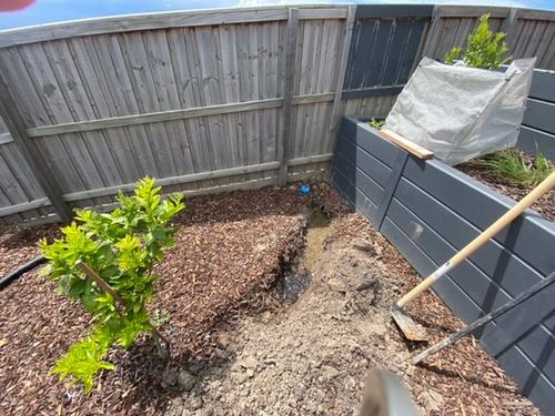

These two agi pipes bring water from the front garden. A drop of .5-1.5m front to back.
Soil is solid clay. From this discharge point next to the fence the yard drops a further meter to the back fence.
I was thinking of draining the water towards the citrus tree. But water logging is a high risk.

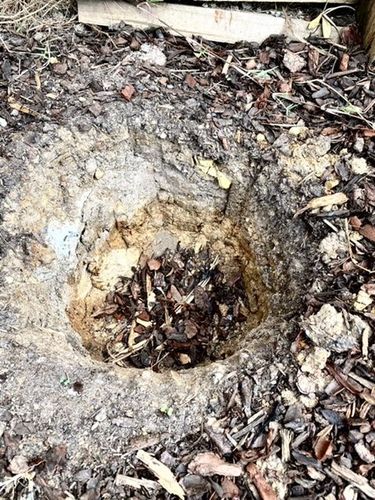

Or drop a leaching tank into the ground. But given the soil profile you can see in this hole below from elsewhere in this garden it’s clay all the way. So I suspect water dispersion from the leaching tank may not be successful. Unless the hole is oversized and filled with gypsum and soil. Is this the best permanent solution?
Advice and practical ideas very welcome please.
