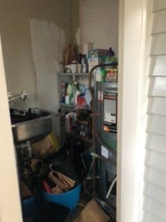

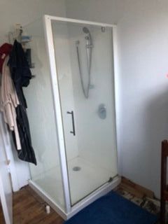

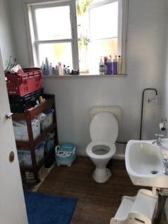

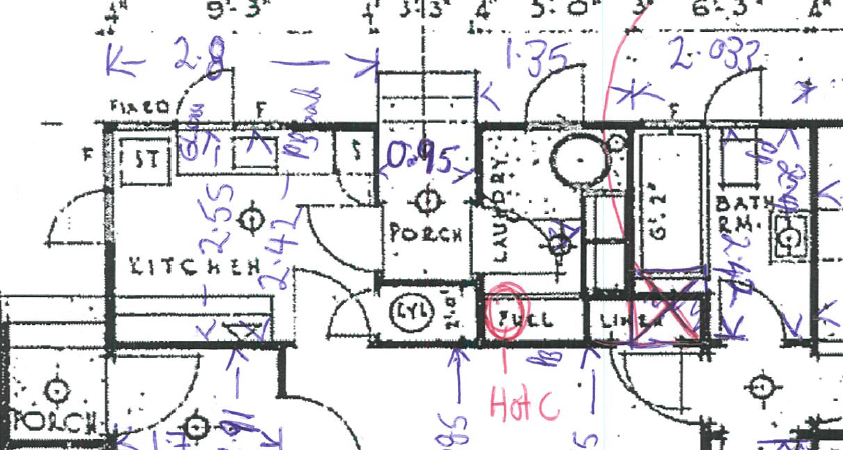

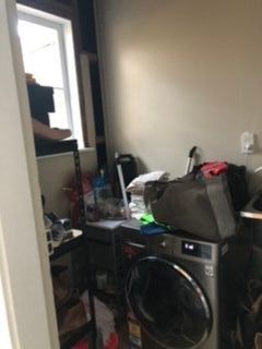

I have existing kitchen, porch, laundry and bathroom that need upgrading and I'd like to maximise the usable space but so daunted on where to start. The laundry is currently used as a dumping ground and far too big, the porch entry door can be moved to line up with the external face of the house so we can incorporate the extra area there too (although it will need to remain a walkway through to the living room). The image is from our original house plans, not much has changed since 1940 except the linen cupboard and bath are gone and there's now a shower there. The top wall on the image is the external face of the house and the bottom wall is structural but the other walls between the rooms can move. The depth right along is 2.42m. The width of the rooms at the moment are kitchen 2.8m, porch 0.95m, laundry 1.35m, bathroom 2.03m

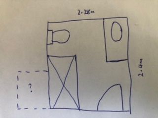

We were thinking we could use part of the laundry closest to the kitchen as pantry, add the rear part to the bathroom but can't work out what items we could fit in the bathroom (will it be big enough for a bath, shower, toilet & vanity without looking cramped - don't want a shower over bath so otherwise will forgo the bath). We thought perhaps the washing machine could go in the area marked on the plan as 'cyl' which is the old hot water cylinder which has been moved to the corner of the laundry marked as the red circle.
Any ideas on configuration and especially around the bathroom as that is the most urgent and we are thinking we could upgrade that in isolation first.
