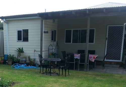

Before:

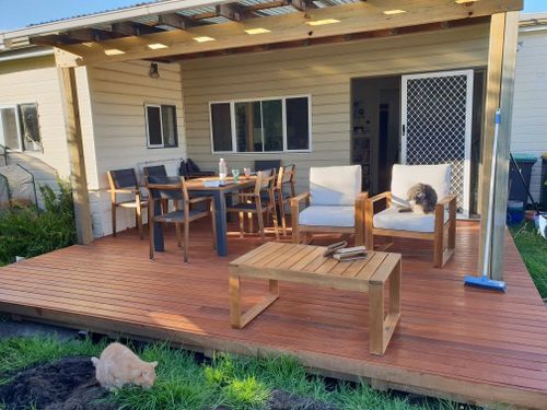

Finished product is great and we’ve had a few sunny days to enjoy.
I’m really proud of the work I’ve done. Thanks workshop community for all of the helpful ideas and information.
