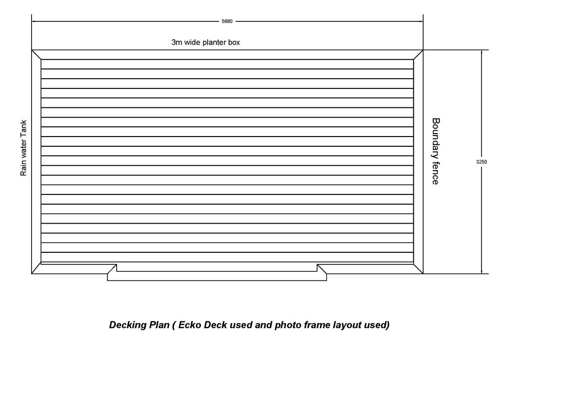

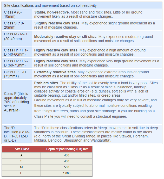

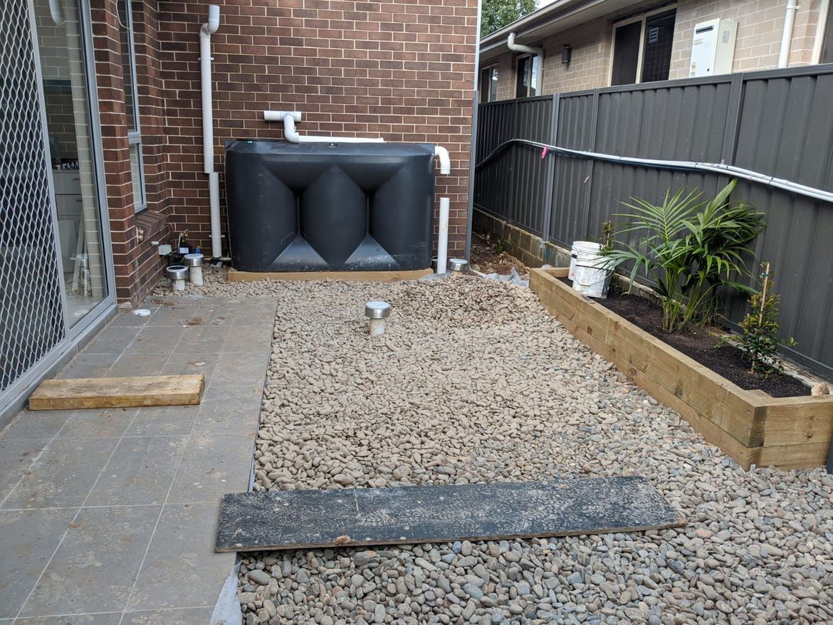

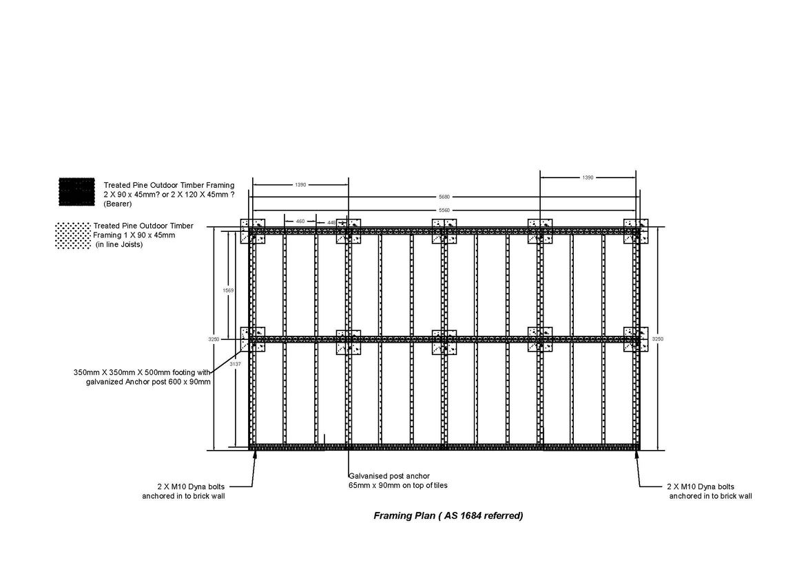

I am trying to design and build a 15m2 low level timber deck at my back yard. This is my first time building anything my self and I am a civil engineer by profession. I have attached the layout here for reference. As this is my first time , I would need assistance in designing all the elements of the deck - foundation ( depth of the hole for concrete , stirrup and posts), ledger, bearer and joists. For the decking I am planning to use EKO DECK+ from Bunnings. There are pebbles spread out at the proposed decking area and if possible want to install this deck from this pebble level. Proposed timber deck is outlined with yellow lines in the attached photos.
