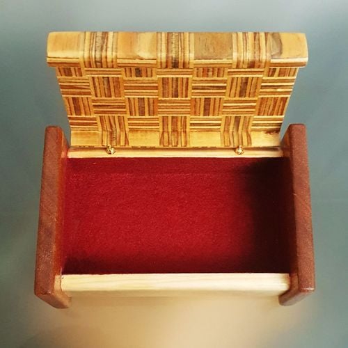

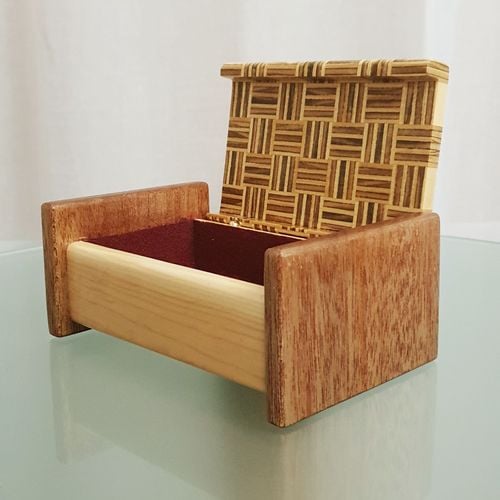

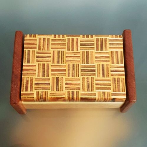

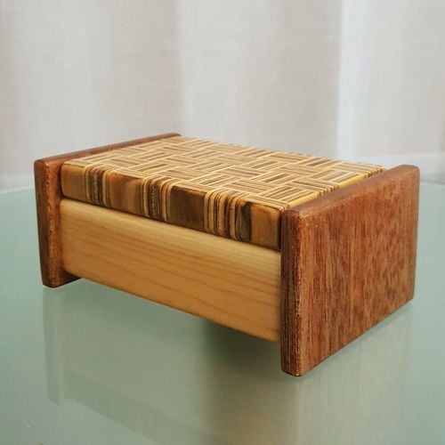

Sharing with you another small project I've built when I had too much small offcuts laying around... We all know this situation, when we have these thin strips of plywood left, and the only place they go is the fireplace.... But a little glue, and then decent sanding and finish will end up in this box lid!
Sides - pacific maple. Body - laminated (fancy word for glued 😉) 50x19mm thick recycled pallet wood planks. Decorative barrel hinges and lid made of few strips of 19x19 mm mixed ply strips, laminated... The cavities for both body and lid routed with a straight mortising bit. Sides joinery - mortice and tenon. Eventually, the inside flocked with burgundy flocking powder.
