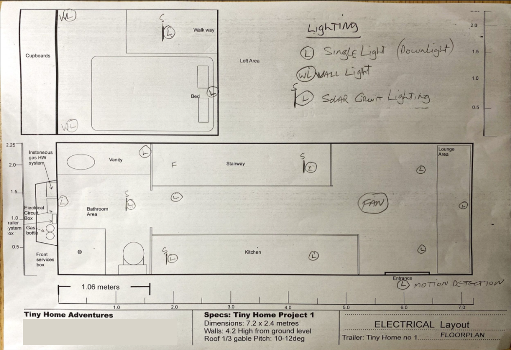

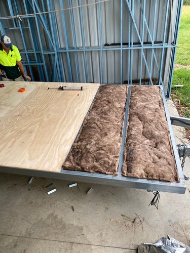

So we are building a steel framed building on a trailer and I’m going to post some ideas...make sure you insulate any floor in building any home as the costs of heating and cooling is getting expensive.
these tiny homes are off grid and operate on solar power.
