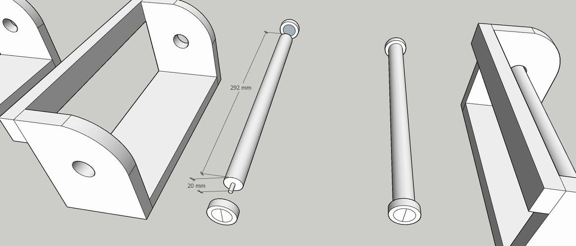

- mounting the knobs to the dowel. Drill a hole on the end of the dowel with an M4 drill bit dead center. Screw the bolt that came with knob set into the hole you just drilled. Cut the head of the bolt with side cutters and leave at least 5mm to allow you to screw the knob to the end of the dowel. ( refer drawing )
You may design your own dowel end holding system! You can make it as ornate and be-jeweled as you like, whats important is that it gets finished on the weekend! Good luck and stay safe.
