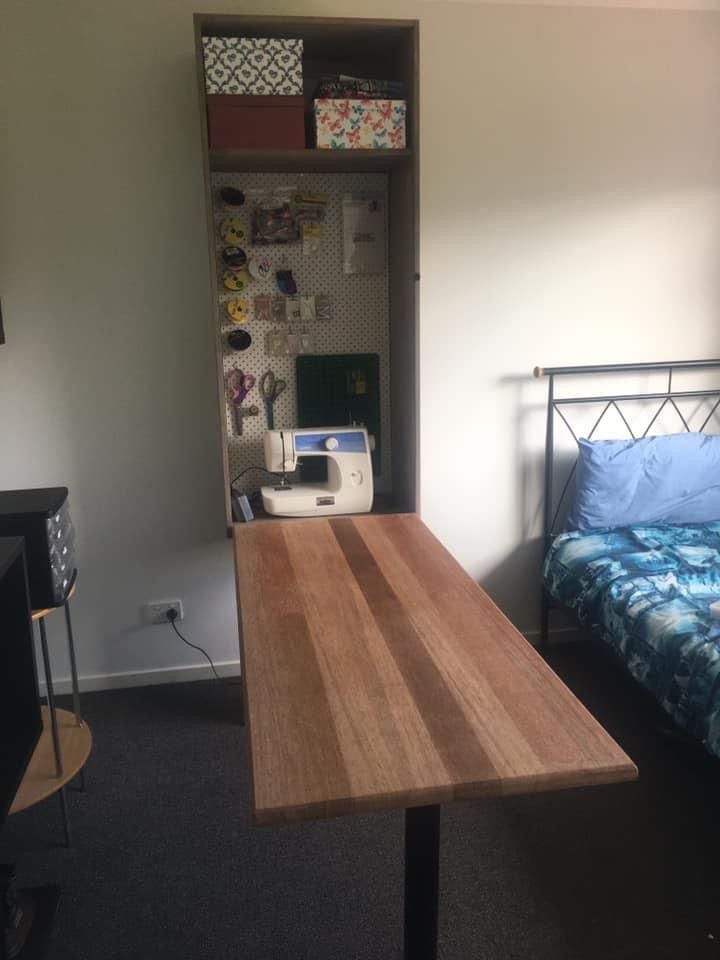

My wife asked for a sewing table so after some discussion on what she needs, I started this week end to make a drop down sewing table with storage. as you may see I used the Kreg screws joints as I wanted to try them so I brought the kit and the wood from Bunnings.
not totally finished but I am happy with it so far.

I know this post is a few years old now, but I've been trying to get some ideas for something similar to make for my daughter. As they live in a small home and she has to use the kitchen table, like many of us starting out.
I came across this post and just think it's perfect. I am wondering if there is some way to hide the hinges? Possible have them on the inside? Are there different hinges that I could possibly use to create something along these lines?
I've never been great at fitting hinges, I always seem to make a bit of a mess - but would like to create something along these lines. Any suggestions would be greatly appreciated.
Also how is the leg support fitted? I was toying with creating something that also hinged at the top of the fold down front, that actually dropped down and became the support leg.. just a thought.

Hi @Old-gal24,
It would be a little more difficult to conceal the hinges. They'd need to be rebated into the bottom edge of the fold-down section and the carcass.
Having a fold-down leg would also be a neat solution. As the table is lowered down it would fold out for easy positioning. Hopefully, @Gareth can fill us in on how the leg is fixed in place on their project.

I had to fit the hinges like this as the wife wanted to us the whole length wit no step down, the hinges could be done different for sure, with the leg I had to use one that we screw in as again the wife want the full length mirror and did want a leg dropping down in front of the mirror. I brought the leg and bracket from Bunnings of coarse.
I hop this helps and thank you so much for liking my little project and the wife is happy so happy life
