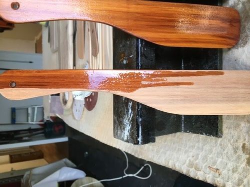

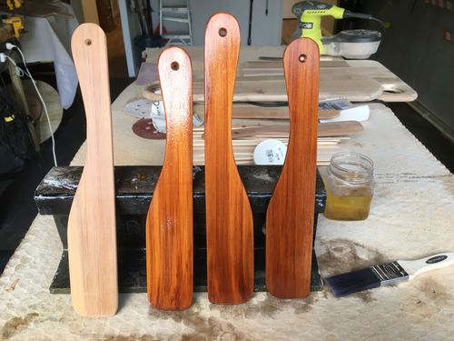

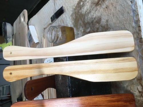

From some 50 year old rimu (red pine) I cut off the nailed and daggy bits and with my ryobi circular saw cut the 1 inch 4x1 in half and used my ryobi plane to get the thickness to around 4mm. Marked out the spoons and cut out with jigsaw. Sanding to finish. Also did the same with some 10 mm untreated pine from Bunnings ( didn’t cut it thinner just planed down to 4mm. Oiled with bench top food safe Tung oil. Wipe excess off after an hour and leave for 24 hours, repeat oiling wipe and dry. Ready to go
